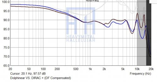

Me and their boss are friends, so you may tune down my words a bit. But measurements are pretty good.
JohnYang1997
This is the measurements of kanas preproduction when we we were discussing the tuning. The one up is raw the other one is compensated couldn't remember which compensation I used but I think that was good enough.
Measured with bk 4195.
