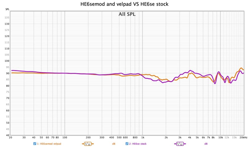

Mitch, over at Accurate Sound, has developed a filter set for the HE6seV2 and it's one of the cheaper filter sets ($50) he has to offer. I purchased them and I really like what I hear. I wanted to recommend them to anyone looking to get a more neutral sound out of theirs. The frequency range is very even throughout with no peaks or deficiencies. The other EQ's I've tried, like oratory1990's, feel very heavy handed compared to this.
Jun 8, 2023 at 4:34 PM Post #2,309 of 2,647

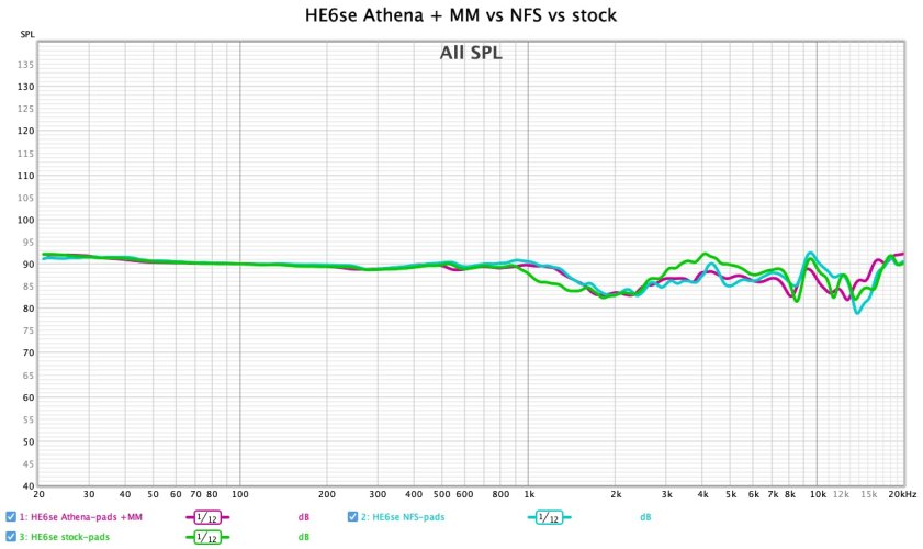

Jun 11, 2023 at 2:03 PM Post #2,310 of 2,647
