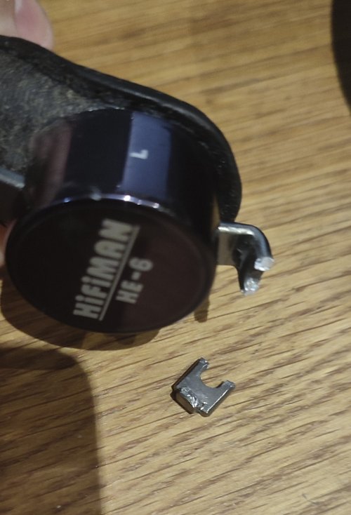

Does anyone know the size of the 4 screws holding the earcup/driver (whatever you call it) to the headband? Mine had loctite, so I nearly stripped 2 of them... So I want to get new.
M2 threads 6mm length?
