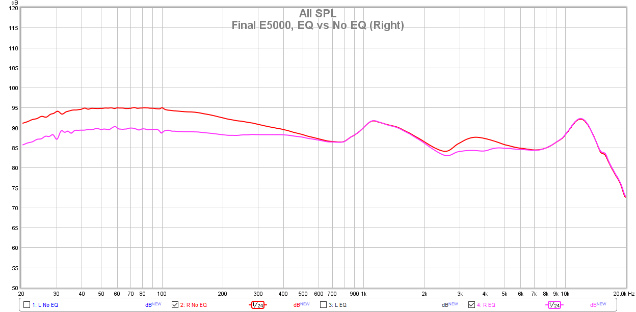

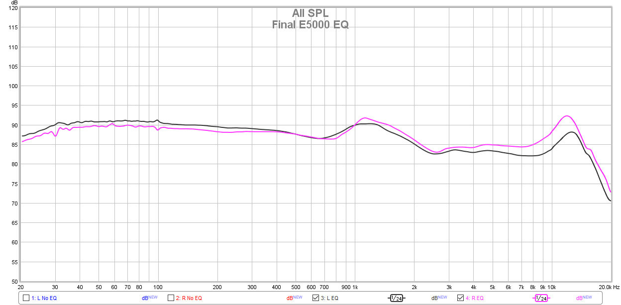

I'm not sure how you guys feel about EQ, but I got down something I quite like with the E5000.
Of course, YMMV with preferences and all, but I'm curious as to what you guys think of the results with the EQ. Program is EqualizerAPO with Peace GUI.
My goals were to reduce the bass bloat and have vocals sound a bit more natural.
  • -5.5db at 300 Hz, Low shelf filter
  • -3db at 3.5 kHz, Peak filter, Quality: 2
  • -1db at 4 kHz, Peak filter, Quality: 4.32
For the Final eartips, I may decrease just 0.5-1 db at 3.5 and 4 kHz to have similar results, but I haven't measured nor listened with those eartips with the EQ. It shouldn't be too much different from the stock Final eartips.
Measurements:
This was measured with the Sony hybrid eartips.
I tried adding a boost around 20-30 Hz to have it "linear", but I didn't quite like it so I left it alone.
- MiniDSP EARS, MiniDSP EARS In-ear diffuse-field calibration
- Matched at 1 kHz
