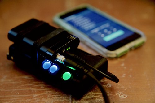

For those who needed to replace your poly under warranty were you able swap out in retail or did you work directly with chord?
Mine has no M status light and will not connect to WiFi. Bluetooth works though when no wifi networks are stored in it's memory.

May 26, 2018 at 3:45 AM Post #9,714 of 19,970
Mine has always been defective. I didn't realize it was supposed to do anything until reading some posts here about it.
There isn't an actual light there - its a short piece of optical fibre routing the Mojo's light to the Poly M light hole - and it can get dislodged/knocked out of alignment.
May 26, 2018 at 4:38 AM Post #9,716 of 19,970
If you look back I don`t know how many posts (lots of them) search for pictures maybe, I have shown my Poly case open with the light ''tube'' and how I kinda fixed it to stay in place. It`s Mojo`s light going through. Since then I totally replaced the part with a piece of optical fiber cut to dimension form a regular optical cable. Much better! Mine was displaced as it arrived.

M status is mojo’s light, mojos light travels via a light pipe/fibre optic from mojo to poly and to m status, it is not a physical light on poly, its just mojos light.
Mines is slightly out of place also, but it still shines, but only 1/2 to 3/4s
Might actually do the fibre optic mod, if its better than the default pipe.
What I think maybe happening and I am not sure, in one of the pics I saw tape holding the pipe to the inside of polys case.
If that is how it comes from chord, if the light dims or disappears, the only thing I can think of is the heat from poly and possibly mojo, the heat may make the tape dry up and come loose and the pipe may fall out of place ?
If the pipe isnt held in place by tape then forget the above.
