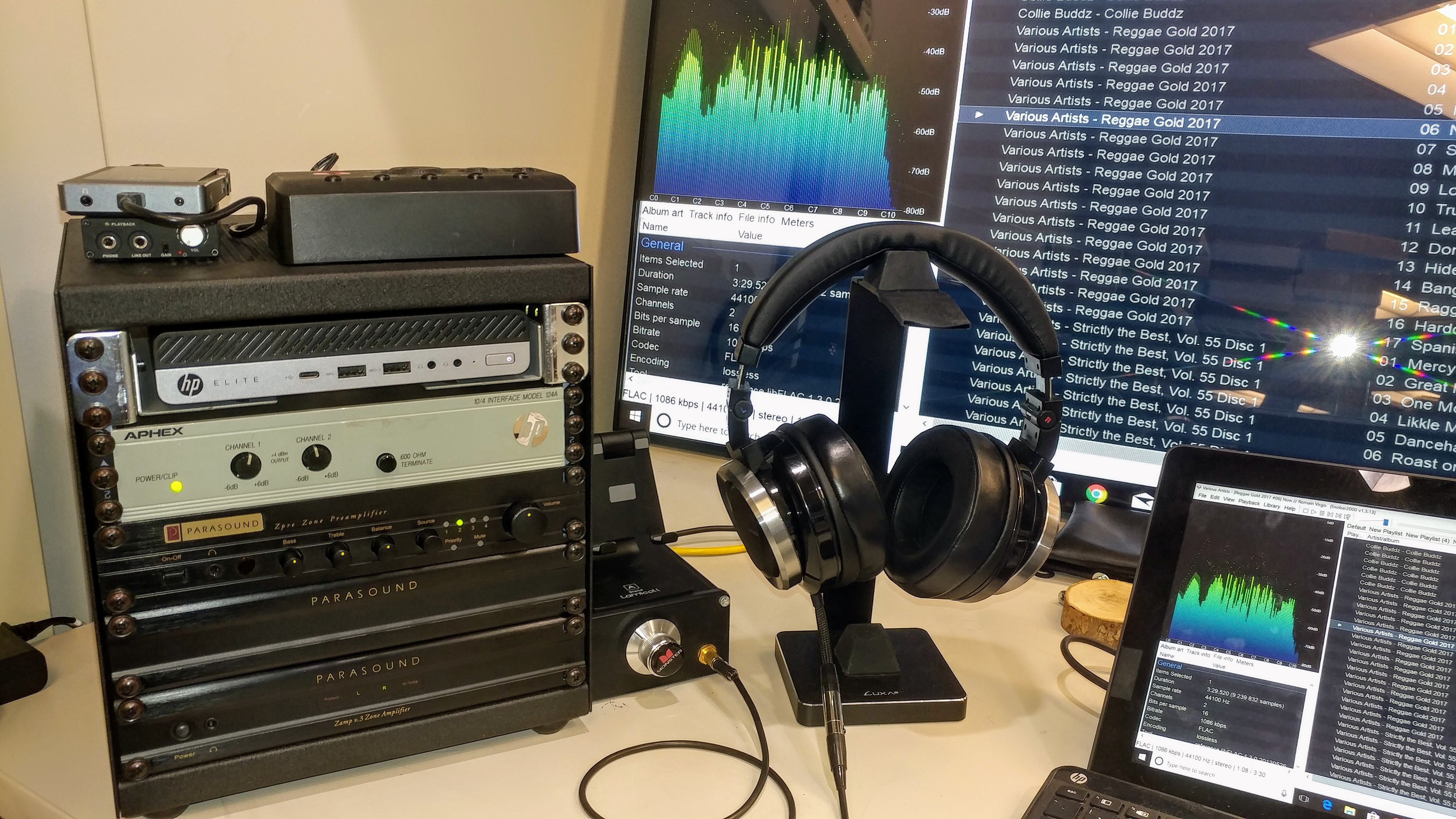

I scrabbled up a different Parasound setup and stuck the V6 Classics that I got from Charles @ Burson. I was previously running my favorite V4's in these. Today I swapped in the V6 classics in both the preamp and amp. I get more airiness out of my closed back headphones. Subbass is still there, but it is different from the V4. To my ears the V4 beats the V6 by a little bit. But other than that, the V6 classics are pretty damn great sounding.
