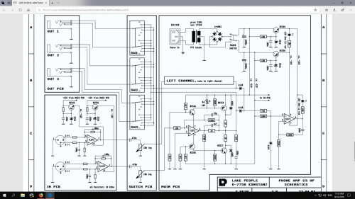

Perhaps you guys can help me. i wanted to upgrade the op amps in my lakepeople g5hp. Since I could not find the burson v5i anywhere in Germany, I ordered opa134 for the time being, till I get the v5i's in there. But now I have a problem with the thermals, it seems that the transistors are overheating in about 3-5min. Any ideas on how to mitigate this? Here is the schematic:

Is audio out working or there’s no audio at all? Can you measure BD transistors temps?
The audio is working great for the first couple of minutes, though it is bit quieter it seemed. after about 3-5 minutes it starts to stretch the sounds out, everything sounds wrong and kind of slows down, like it would be braking. Unfortunately can not measure the temps but those transistors are hotter than hot, can not touch them after 5 min. While with the original tl071 they are barely warm at all.
Thank you for your time.
Sep 23, 2018 at 8:09 AM Post #235 of 553
Maybe your OPA134 are oscillating, you need a scope to test the amp with square signals. You should probably stick to the original TL071 unless you’ll find perfect compatible opamps.
Thank you, will try and obtain one for measuring.
Sep 23, 2018 at 10:22 AM Post #237 of 553
Transistors will normally be hot, especially in BIAS Class A (can be up to almost 100 degrees Celsius).. But OpAmp´s sould not be too hot.
Sep 23, 2018 at 12:23 PM Post #238 of 553
In many schematics, it will be fine to swap OpAmp to almost anything (that will PIN-compatible and work within it´s specific voltage area).
In my headphone amp - Lovely Cube, almost anything seem´s to work fine.
In my CD player Harman Kardon HD970, LM4562 did´nt seem to work at all. Replaced with THS4031, and it works gorgeous now!
