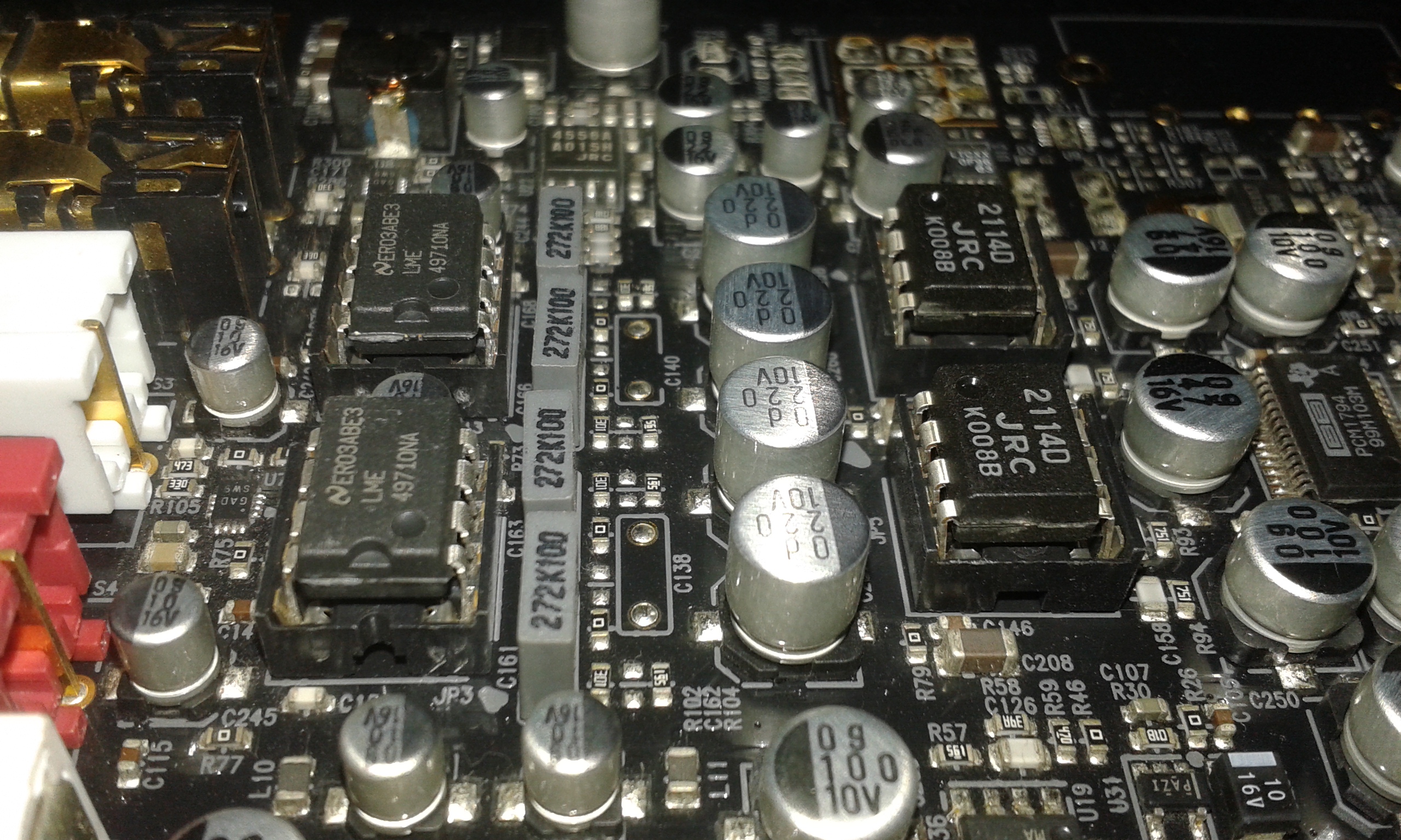

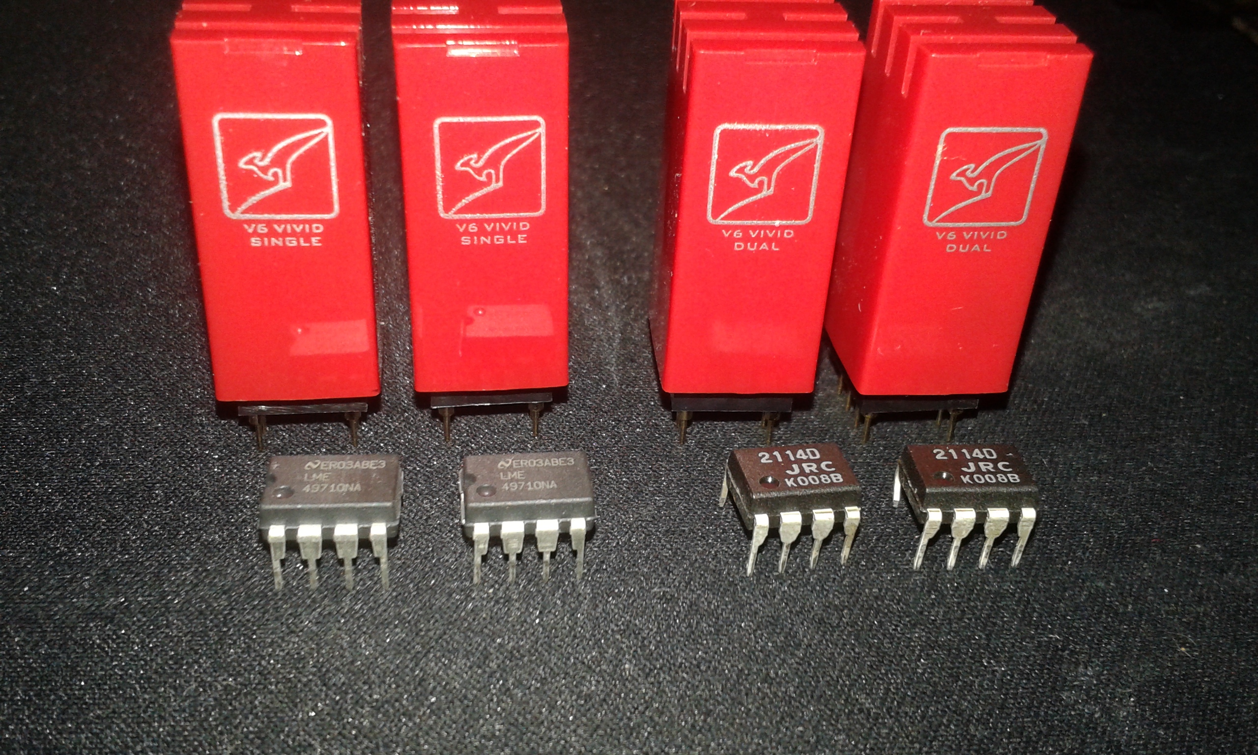

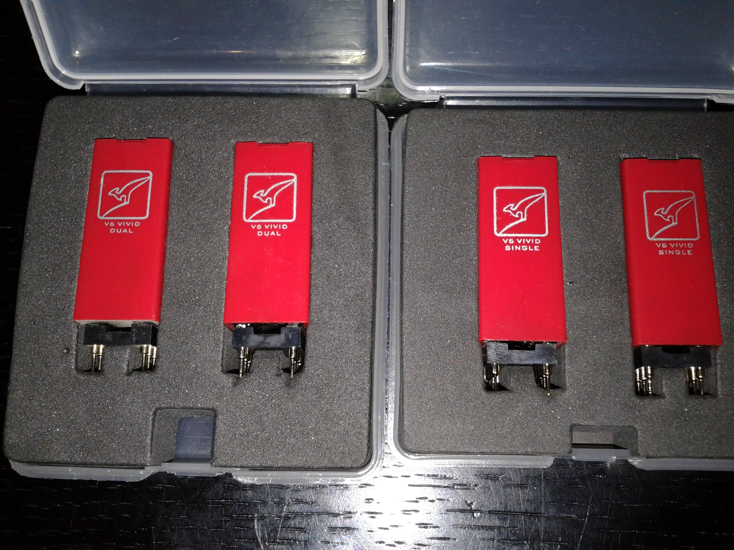

I decide it's time to start writing a review about Burson Audio's Supreme Sound Opamp V6 Vivids because otherwise it would never be finished.
First of all many thanks to Charles from Burson Audio for sending me the opamps.
I'm using them in my Creative Sound Blaster X-Fi Titanium HD, the V6 Vivid Duals replaced the default JRC 2114Ds and V6 Vivid Singles replaced the default TI LME49710NAs. For now i'm using a pair a of JBL 305p MKII, the sound card and the monitors are connected with a pair of Oyaide's Neo d+ Class B RCA->XLR cables. Power supply is a Seasonic M12II-520 EVO Bronze.
Using in Audio Creation Mode with Bit-Matched Playback enabled and foobar2000 with ASIO.
The opamps:
Some perspective:
The soundcard before:
And after:
I only started using all of them in this card a week ago, so as i read and experienced with Auzentech X-Fi Prelude, they still require lots of usage before excellence, but i can say with absolute certainty:
