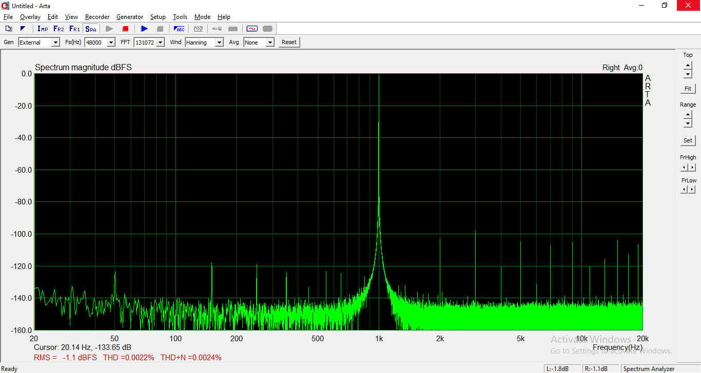

After reading http://nihtila.com/2017/01/12/pcm1794a-leftright-channel-differences/ I tried a couple of tests to check for THD+N with MUSES01 vs. NE5532P used in I/V stage:
MUSES01 in I/V, THD+N: 0.0067%
NE5532P in I/V, THD+N: 0.0024%
Having the second harmonic so close to -80 dB made me "downgrade" the I/V stage from my beloved E1 combo from MUSES01 to NE5532P. Now the second harmonics gets below -100 dB, hence the lower THD figure.
NE5532P was manufactured by Texas Instruments and are the originals from the E1 DAC. Same values I got when I used JRC2114D opamps.
MUSES01 are originals, bought from Profusion UK, JRC/NJM dealer.
The above values are not modified when swapping opamps in LPF, nor in output buffer or headphones gain stage (tested with MUSES02, LME49720, NE5532P, JRC2114D). However, worth mentioning that when using MUSES01 in LPF or VAS the 2nd harmonic is increasing with 2-3dB over the 100 dB horizontal line.
Given the above, I don't recommend spending money on MUSES01 in I/V stage of the Essence One MKii, although in other audio equipment could have better measurements (I will probably try later).
Note: I must confess that in previous A/B tests with an identical E1, comparing stock opamps with MUSES opamps, the MUSES version was more sound appealing, with better soundstage...more euphonic and pleasant sound. However, better THD+N means a sound more close to what the recording company intended, so my MUSES01 got out of my E1 last night. :frowning2:
