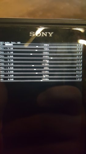

Hi guys,
I have a suggestion and a question,
First, Can we gather different eq recommendations under one post by any means instead of searching each time the whole thread for different eq settings, even people can send their recommended eq to thread owner and pin it on second post or something, if thats an option.
And my question is .. this is the best setting that works for me till now and it gives a clearer sound while still sounding full (other eq settings sounded clear but sounded too thin that it seemed unnatural )
Here is my favorite eq setting on rockbox (original by Kmann) :
But the problem with some songs, there seem to be some distortion that i cant figure which frequency causes it.
Honestly, its my first time to use an eq with an iem, so no experience with it.
I tried some rockbox option called adaptive fatigue reduction and it clears the distortion but it have some effect to it that i dont like.
So any suggessions to modify this eq and fix the distortion. Sure i might fix it with trial and error but better to understand from you here.
Anything you recon is fishy with this eq setting?
Thanks

Hi guys,
Here is my favorite on rockbox :
Thanks

Change 730hz to 800hz and tap it down a few decibels. I found a liking to -6db. But I take it you've adjusted it because you like a more relaxed sound.
If you're wondering about the slight recession for female vocals with higher octave ranges, it's because of the 2540hz -6db reduction there. But I take it you've adjusted it because you like a more relaxed sound.
Also I personally don't like being the thread starter, it's too much work :frowning2:
Thanks buddy, i will alter the values try it out and check how it goes ..
Honestly for the 2540 frequency i didnt modify it at all, took it as it is from some setting posted here, but doesnt feel recessed to me at all, if anything at all it sounds good with most of female voices and shouty with some exceptions of them, but i will alter it also to check the difference ..
Ye, the thread starter always has a lot of work :D
But i mean if it is accepted as a concept may be i can help and others too, the problem that each one keeps modifying and improving on their settings, at then end too many eq settings scattered around..
I will try also your equalizer apo, the problem i cant find an android app with more than 10 bands except may be onkyo hf and i hate its graphical equalizer it sounds a bit odd to me, but i will find a way to try it out.
Don't worry about trying my settings out, yours is very similar and sounds great.
