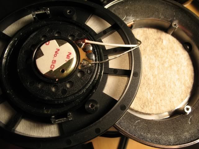

Sovkiller, it looks like those diodes are in parallel with the drivers on the PROLines? Now I'm confused. If they're in parallel, they could only subtract impedance, not add it (if it does anything at all, and it's unlikely that it does much). So what's responsible for the additional impedance in the PROLine? Have you by chance measured the impedance of the PROLine with the diodes in place and confirmed that it is different from the Edition 9's, and not just listed by the manufacturer as being different? I just don't know what would add impedance. And yeah, thanks for the pics. Interesting stuff.
Aug 30, 2008 at 9:23 PM Post #87 of 924

Sovkiller, it looks like those diodes are in parallel with the drivers on the PROLines? Now I'm confused. If they're in parallel, they could only subtract impedance, not add it. So what's responsible for the additional impedance in the PROLine? Have you by chance measured the impedance of the PROLine with the diodes in place and confirmed that it is different from the Edition 9's, and not just listed by the manufacturer as being different? I just don't know what would add impedance. And yeah, thanks for the pics. Interesting stuff.
Sorry but I never measured them with the diodes on, but IIRC, according to Evan those were the responsible for the difference in impedance, I just measured them clean....But maybe the wire is soldered in a floating tab, and from there to the coil tab, and they are in series, not sure???
But thinking twice you are right, if they are on top, does anybody had any PROLine on hand that could measure them??? That will expose if they were indeed 40 ohms....
It does not make sense to me to have diodes in series. Diodes have a threshold voltage before they pass any current through (about 0.7V for silicon). In parallel they could act to shortcut the amp if the voltage to prevent the driver blowing.
However, given there are two I don't really understand the configuration. If the two diodes are in series, that would double the threshold voltage but act only one way.
(My electronics experience is way back, I might be talking complete bollocks too.)
Aug 30, 2008 at 9:47 PM Post #90 of 924
They are soldered in opposite direction, that is for sure....
