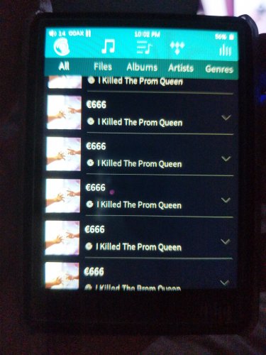

Hey Guys, got my R3 today and it is beautiful and sounds wonderful. Although there seems to be an issue with the "shuffle" function. I popped in my 200gb card with just shy of 15,000 track on it. I set the play mode to shuffle and started the first track. all was well until it moved to the second track ( Like Clockwork/ Queens of the Stone Age). This track then repeated multiple times only with a different track number (4455, 8641, etc.). Occasionally another random track would be thrown into mix, then another 5 or 6 repeat plays of Like Clockwork. Is this an issue that has already been discovered and if so is there a future firmware fix in the work?
This is the exact issue I've been having as well. I have a 200GB card with 17,500 songs on it, and have a track (€666 by I Killed The Prom Queen) that just keeps appearing in shuffle mode and takes 5-10 skips to get to a new song, just for it to go back to €666 again afterwards. When I look in 'All', I also see this:
This song is only actually on my R3 once though. As you can see below, when I click on the song to play it, it highlights all of them which indicates the song is just the one file being displayed multiple times:

very same issue I was to post. Shuffle and same song repeats with different numbers.Kept pressing the forward button on the jabra 65t multiple times.
edit:
it hangs on characters in file name, example Ü. This can get very annoying, very soon.
edit 2:
Argh--it also hangs on Norwegian characters like øæå.
No way im going through my entire card to change this
Yes, I have a few files with Norwegian characters too and they were originally the songs that my R3 was getting stuck on. I think they need to add support for more character sets.
