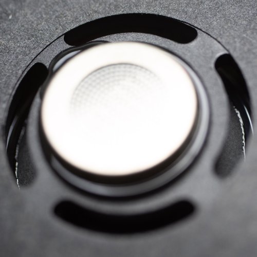

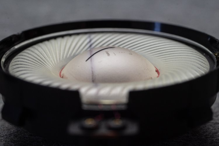

HD590 driver, still installed (I usually don't take my cans to bits
Type: dynamic (center open, ring magnet)
HP model: Sennheiser HD590
Diameter: ~50 mm
Duofol diaphragm
Impedance: 100 ohm
Front view attached here. (Direct link, not sure whether it works.)
Back view attached.

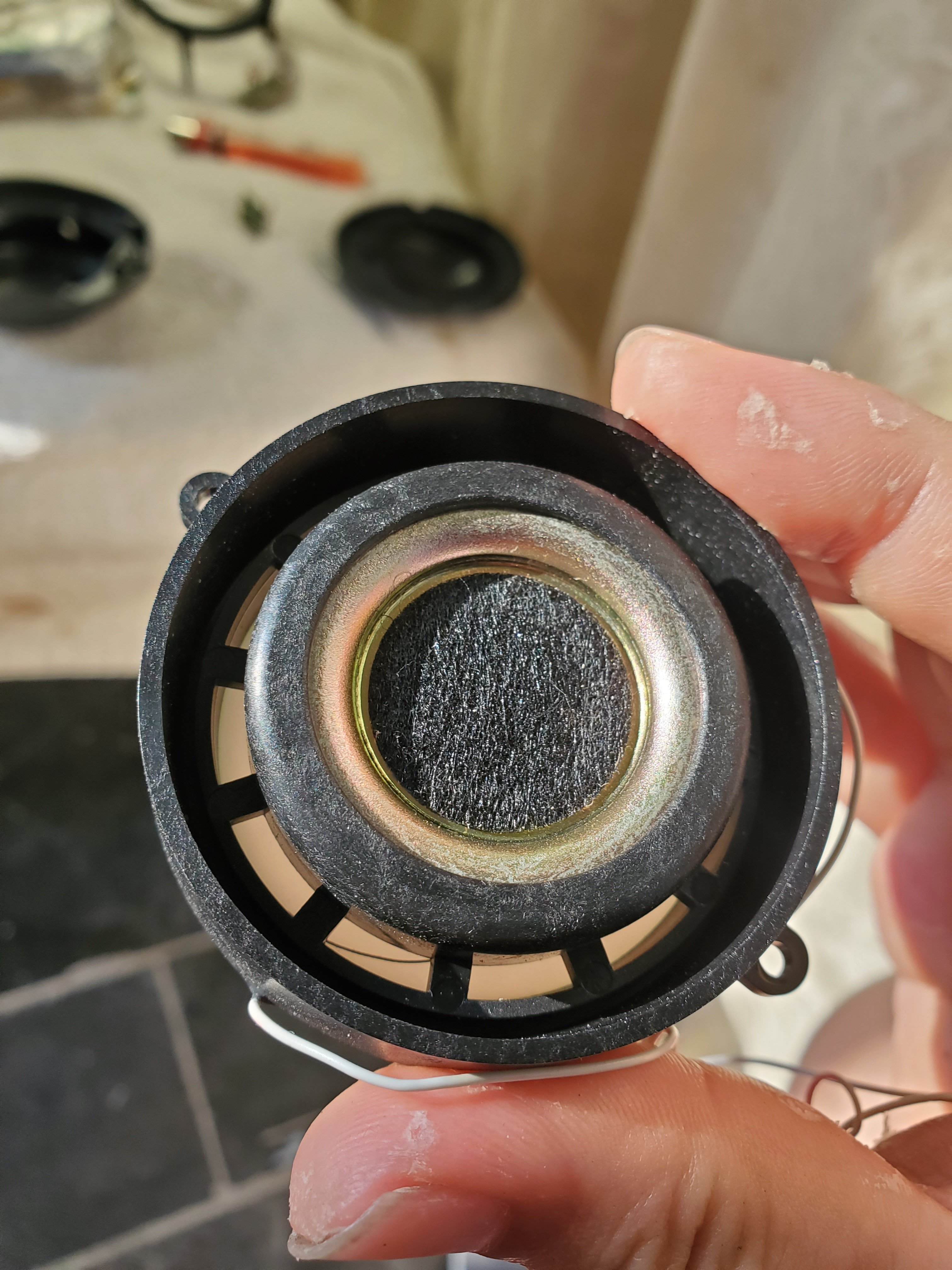

Type: dynamic (center closed/vented)
HP model: Philips SHP805
Diameter: ~40 mm
Impedance: 32 ohm nominal (~37..38 with cable)
Back view of SHP805 left driver
