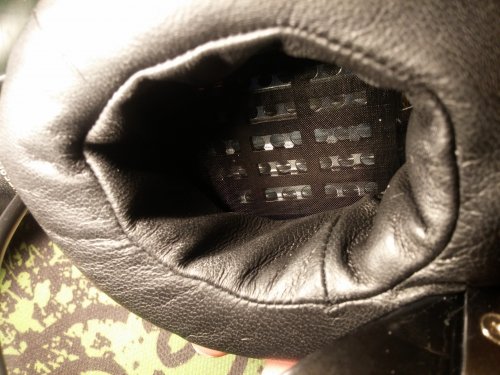

After taking the stock pads off, I noticed, that the drivers had a thin mesh protecting them, and the stock pad had yet an other layer of mesh sewed on. So the drivers are covered with a double layer of mesh, essentially blocking off high frequencies.
(Layer of mesh on earpad)
(Layer of mesh covering the driver)

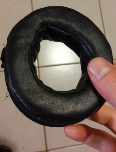

I had a set of pad that I made from leather for a diy project, and those pads didn't have a layer to them so I swapped them. After putting them on with the diy pads, the sound became 'unveiled', much clearer and a tad bit brighter, so it's worth a try, if you have this problem as well.
