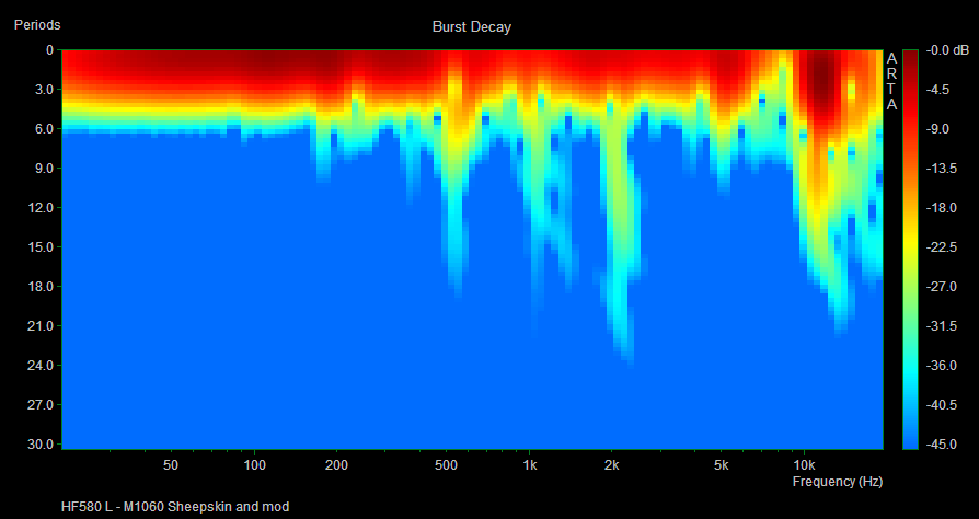

This M1060 sheepskin earpad.......... SERIOUSLY? I get midrange to rise and keep the treble same or better level. I did not know this was angled... Also subbass goes deeper. More comfort than Brainwavz oval sheepskin. Probably the best earpad I have tried so far for this headphone! :gs1000smile: One treble spike around 11kHz. Easy to EQ but I wonder if I could do some pad mods and lower it. Modded Brainwavz Oval Sheepskin pads have smoother treble but this at stock and better midrange and bass.

I haven't yet figured how to lower that one small treble spike complitely. Do you hear too that treble spike? My is modded so sound is quite different that urs perhaps. Kinesio tape on the inside walls helped slightly. I may try to make my own pads. Pads shape from the inside is most crucial. Is it oval, rectangle or angled. Also how big they pad is also makes sound more different. I think best is try to keep the pads big as possible.

I made some mods to the M1060 pads I have now some kinesio on the inside walls, felt and high density foam under pads. Bretty clean burst decay. Of course all my other modifications inculed. Hot spot at 11 kHz still exist. I think this headphone is still very clean of disortion. I don't hear any unwanted messy thinks but more like ringing sometimes. I can't measure disortion very well but you can get the idea where is the hot spots and they are only on the upper treble and low middle if you not mod.

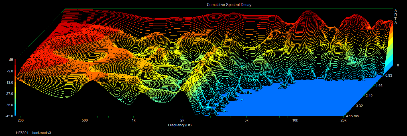

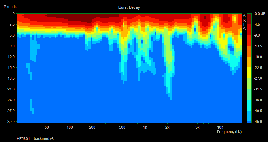

Hmm. I think I nailed it again. More back dampering. No spike treble but it still very strong. Some elevated upper bass and low mid range. Its over 95% closed headphone now. Subbass is a bit on shy side but easy to equalizer. I need check when I have more time if I need all those multible layers of back dampering. May be a bit messy and dffficult to do all my mods....

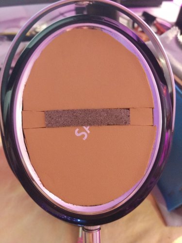

Analytically you've done well, but is it preferable as a closed-back sound, was the brilliance boost right in that detail zone more welcome after the modifications?
What's the trade-off here?
Yes, I know I should have another headphone on the desk that is unmodificated to hear differenties. Sometimes I hear more subbass when modding but then again got more uneven treble.
You lose a lot sensitivity. Something like 8-10dB when doing all my mods I think mobile phone can still light this but not well.
This is my latest backmod. I used leather and magnetic sheets outside because it was brettier than using paper or tape. Use something thick to seall all the leather areas and the box in the middle is medium density 3mm foam. Not sure if u need all the inside mods. Atleast someone can try and listen if its any good? Or do it need to pair with more mods.

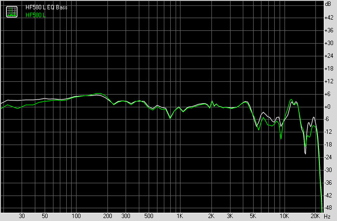

Subbass is a bit shy, even modded. Why not EQ? I use now those China M1060 angled sheepskins. It's difficult to increase subbass. But some back mods helped it slightly.
