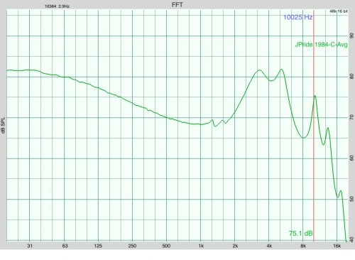

Dayton IMM-6 + PVC tube coupler + AudioTools
Please note that this is not a standard measurement rig. The FRs are useful just to get an idea about where the peaks and valleys are in the curve. Please take these with a tsp of salt.

54JPRiDE 1984 Freedom1D608.1V-shaped tuning, with aggressive treble details, somewhat recessed mids and impactful, defined bass.1JPRiDE 1984 Freedom measurements

I have no experience with those sets in your post but massdrop is currently selling the JVC HA FDX01 @$250usd, which has three tuning filters to change sound signature.
It seems initial reviews are saying the timbre is the best part about it. I was sitting on the fence for very long but decided not to get it in the end as the FR looks like a subbass roll off and I'm a basshead unfortunately.
Thanks! I considered the FDX01 and also the FD02. But, i think i might not get them after all. I'll wait for more impressions on the massdrop model.
Oct 1, 2019 at 7:29 AM Post #12 of 66
@iems0nly since u like DDs, there's a super hypetrain model now in the CHIFI thread, the BLON BL-03, single driver DD. $28 USD.
I'm waiting for my set but the initial reviews all like it for the timbre and tuning. And seems it is suitable for jazz and acoustic type genres. I thought why not for 28 bucks.
But seems the nozzle is short so some of the headfiers use longer nozzle aftermarket tips like spinfits or they do some mods (check out the forums).
