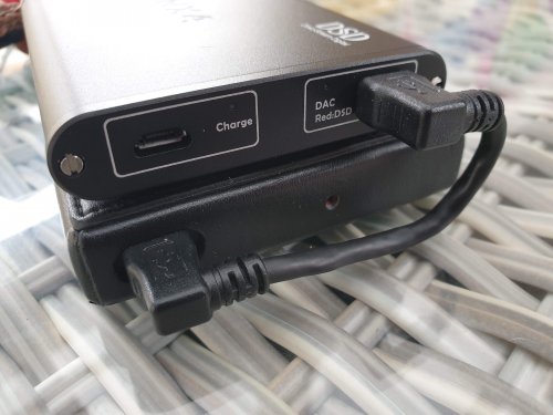

DP-X1 and Topping NX4 DSD working great together. Plenty of power form the little DAC/Amp, great sound quality (no noise floor, channel balance right at any level with Sony Z1R and Noble K10). I finally don't care about flimsy Onkyo audio jacks. I know, I know, an extra device, but the little powerhouse actually looks cool attached to the DAP in its Dignis black leather case. Thanks to this new acquisition I will be using my DP-X1 more and the LG V20 goes to my wife.
One more thing: the bass boost on the NX4 works pretty well actually, love it with rap and EDM. O possible solution to bass lovers that can't EQ in Tidal.
