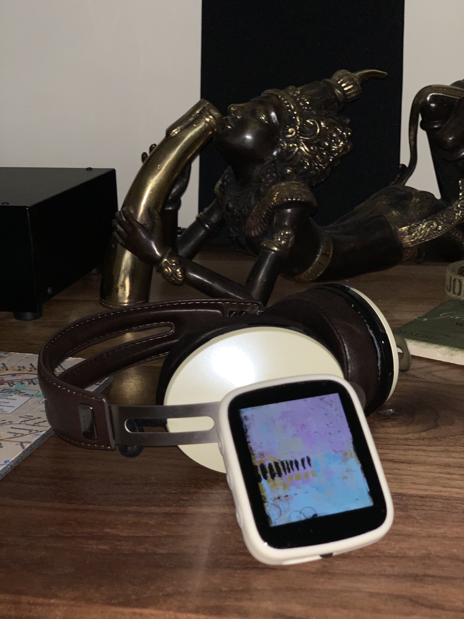

Paired with my recently acquired ivory Sennhesier Momentum HD1 (wireless HPs). A portable match made in Heaven (China & Germany to be exact). 056EDB16-F206-46EA-A704-26E660F84B19.jpegBABB311D-4561-4449-BA6F-866E0FC16A19.jpegA10C02EE-0166-4E6D-8F66-350389FEE1B9.jpeg
