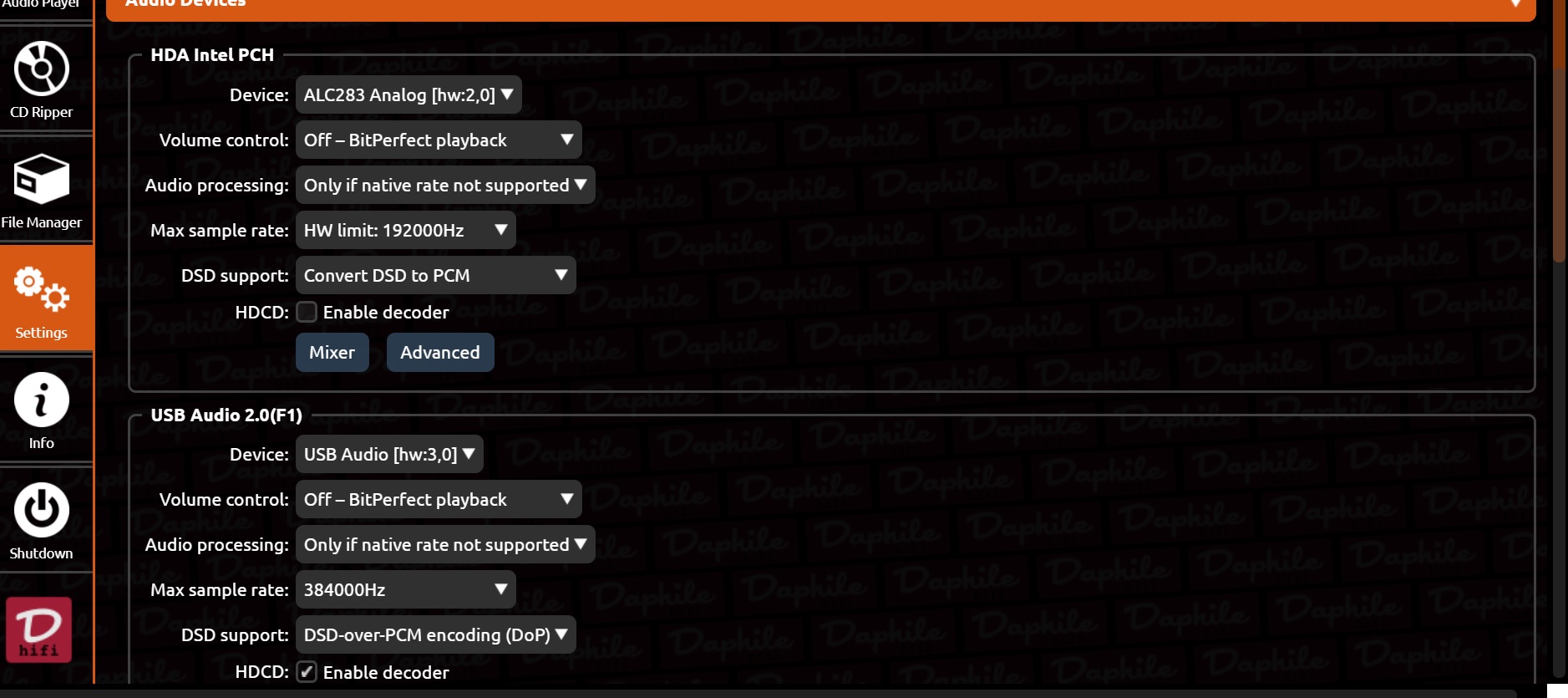

I used Daphile 17.09 x86_rt for about six months, playing HD-DAC1 for decoding and headphone output (cans are HD-800 & T1) and everything is perfect and smooth (no matter in DSD Native or DoP mode) .
But recently wanted to try DAC1 coaxial input, then bought Xingxer FI DDC, after the combination of the sound does have some different flavors; the only regretfully is the DSD can not make a sound (after the Audio setup inside the three settings: Native, DoP & Conver DSD to PCM), regretfully can not do it like to play DSD music files.
Search the Internet after a round, I feel this forum is Daphile most professional and in-depth forum, so I would like to ask you predecessors DAC1 and Xingxer F1 experience, thank you predecessors!
Below attached my screenshots, please enlighten:
if you look at the specs, i don't think you're going to get dsd from the coax output of the f1 -- i think you have to use i2s to make that happen.
hd-dac1 also only does dsd via usb.
Thank you for your reply! It seems I have to carefully study the specifications.
