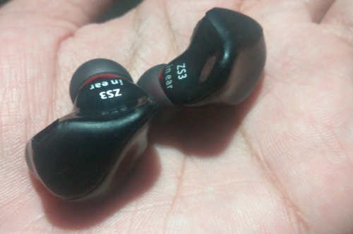

To anyone who wants to remove the logos/brandings on their KZs, use vinyl wrap instead. Just heat it up with a hair dryer to make it stick on a non flat surface.
Here's what I did to my gloss ZS3
Done that before :). It looks great on first week, but because the ZS3 is too curvy, I find that even the tightest fit of vinyl application, it will eventually get loose (I applied 'Oracal' brand vinyl on every possible surface with multiple vinyl parts and heated it).
I find that simply spray it (without disassembly it) with thin layer of black matte spray paint is easier and make better result, makes the $8 looks like $60.
Jul 15, 2017 at 2:09 PM Post #18,971 of 68,025
I only applied the vinyl on the left and right logos. It wont come off easily cause it's a flat surface
