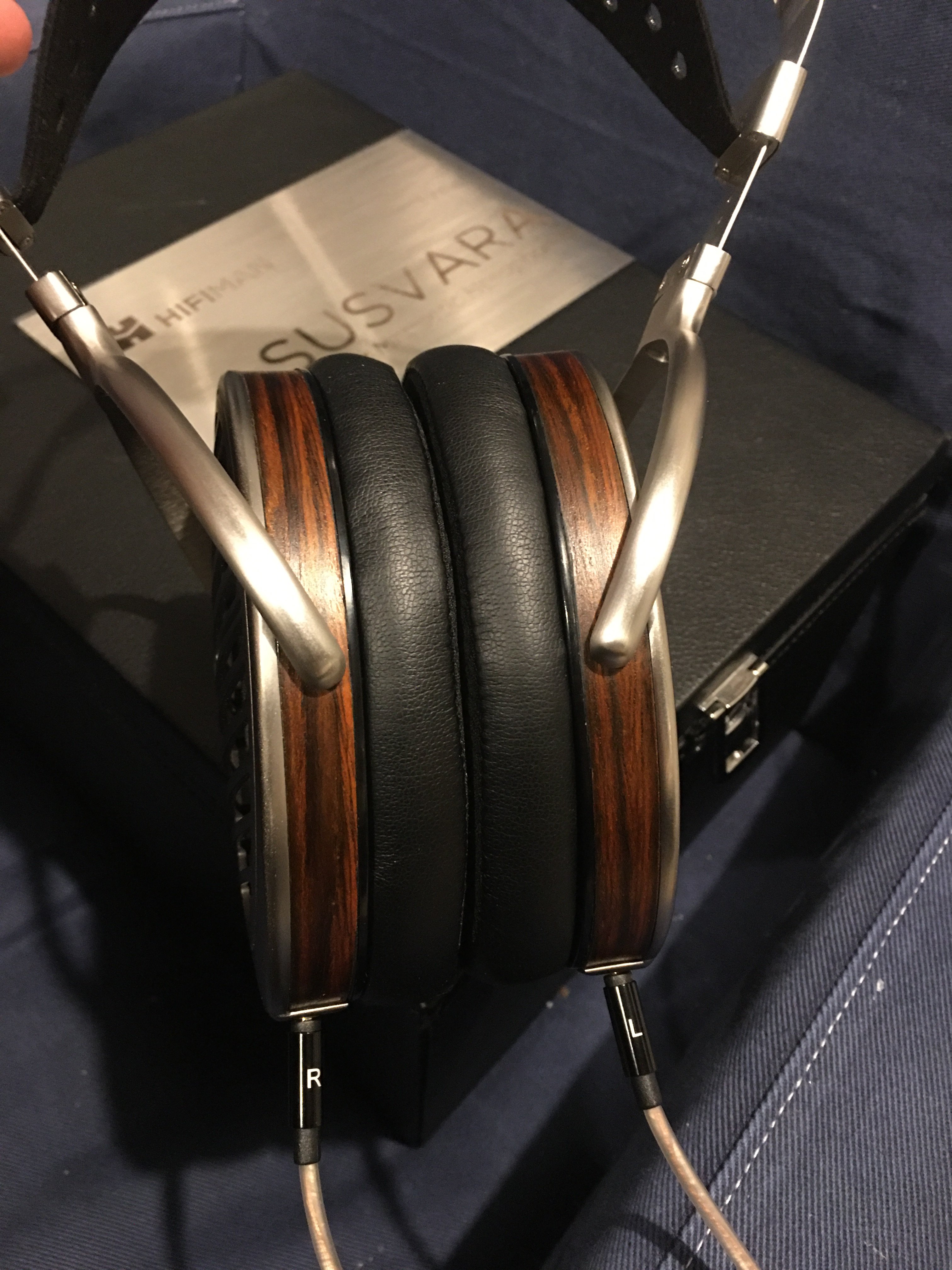

Maybe I didn’t explained well. The first two pictures are after I unglue myself the leather and cleaned the old glue and also aligned the foam to proper match the ear cup position. At first, only one pad had the leather a little loose inside after I cut the cloth that covers the drivers. You are right, they are poor made.

Hi to all, I am a two weeks happy owner of the Susvara (bought second-hand from a good head-fi member). What can I say, they have the perfect timber that gives me goosebumps every time I listen!
At first I was a little disappointed by the stereo imaging especially the right driver seemed not integrated. The HE1000se appeared to be better in this department and also bass and sub bass.
Also I was a little anointed by the cloth inside the pads that touched my ears. I decided to remove it and in that process I saw the leather on one of the pads running off do to old glut.
I decided to re-glue the pads using double sided tape.
In this process I finally figured out why the stereo imaging was of. The right pad had the blue memory foam unaligned with the structure of the cup. So the right pad did not sustained the driver at the correct angle and distance from the ear.
This I saw is crucial for headphones to image well (the same problem was with HE1000 V1 that was fixed with V2).
After I aligned the foam in the correct place I saw that the pads also have their place on the cup near the driver (see pictures above).
So not only the foam was not proper aligned but the pads were not in there correct place (they were moving a little).
After putting the ear cups in the correct place I am literally amazed how good the Susvara stereo image is. Also the bass is more tight and the vocals are very good represented in front.
It is a shame that a good design can be sabotage by some employee that makes the pads and doesn’t understand the impact of minor deviation for the overall performance of this expensive product.
So be aware and check the pads, maybe they’re imperfections have a bigger impact on the sound then other things implied here.
