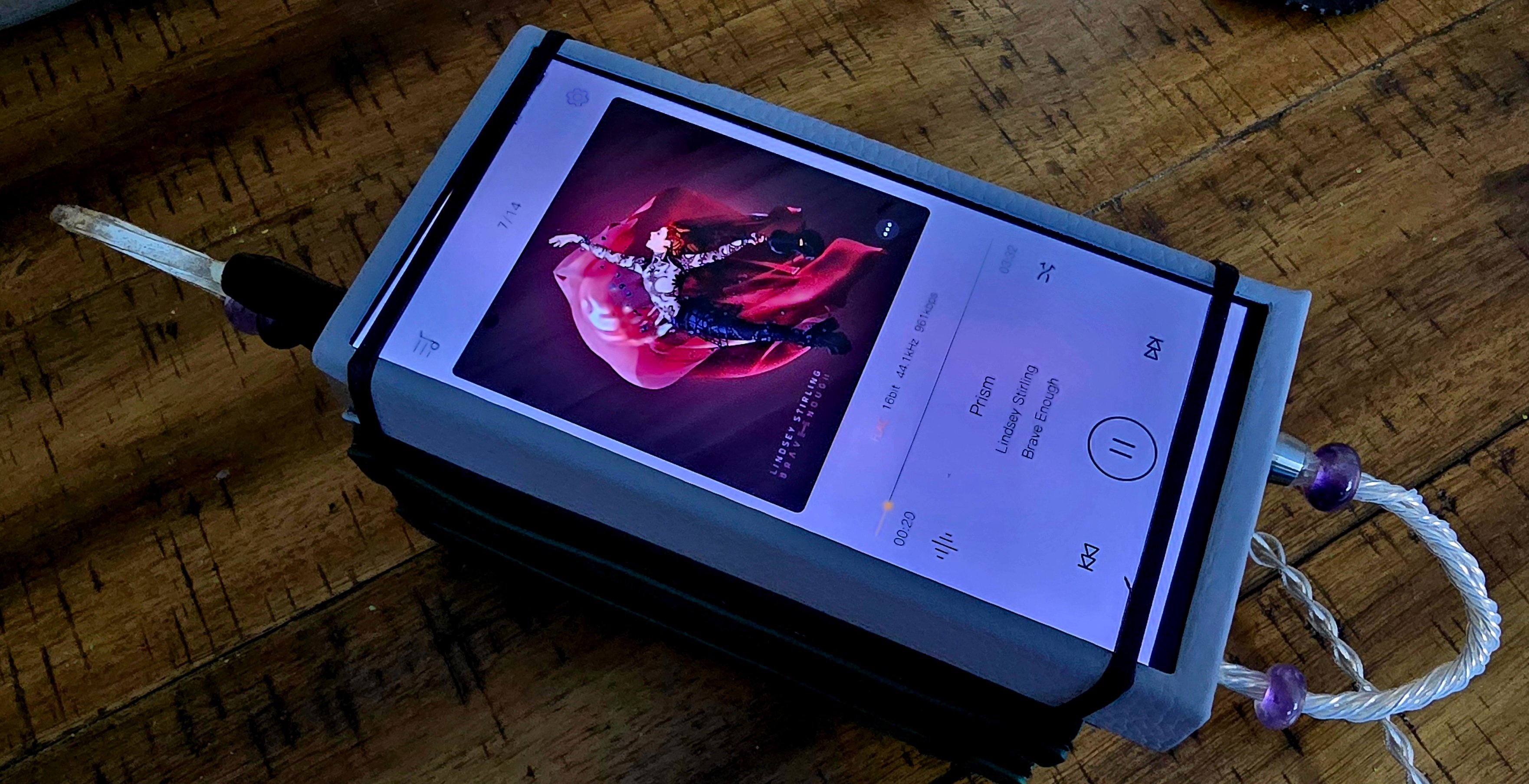

Here is all the beasts working together. The Ibasso current Trinity
Portable anywhere, couch side, bedside, never lacking of power, or tubes, or needing powerbanks 😆
I only use the best for my stuff. Please dont mind my obnoxious cables. They dont look good or kilobuck expensive. But their performances are Real, anyone can hear, and they selectively come from endless of my experiments with a lot of researches, works and $ invested over decades in this hobby 🤑
