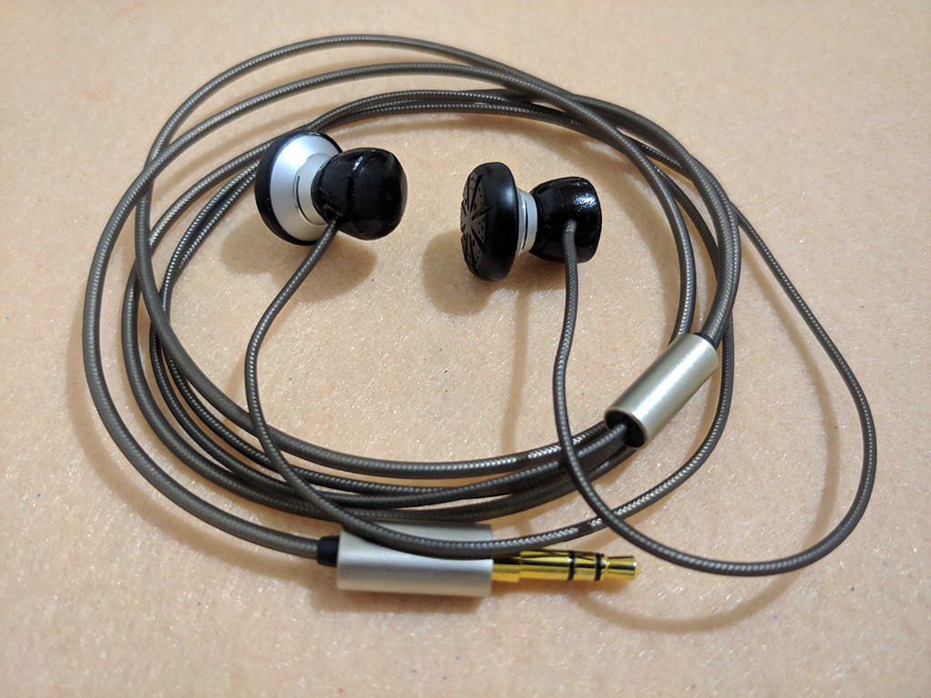

I just finished my hybrid shell model. For this, I used a 300ohm driver N52 magnet, Tingo T200 cable (just temporarily) and aluminum shell (front part only).
300ohm driver requires swapping of this tick filter because it already has slightly recessed mids. Treble is laid-back. Bass is really energetic, N52 magnet does a good job here.
Without the filter, mids come in front, a little too much for my taste. A thin filter with a pair of punched holes provides solid sound.
I like these aluminum shells because are ultra-light and the driver fits perfectly. The only problem is that they are too shallow (very small cavity size).
The back of the shell is a hand-made wooden piece. By adding this wooden part I got medium cavity size which adds a bit "large room" effect
