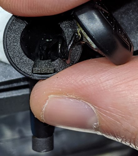

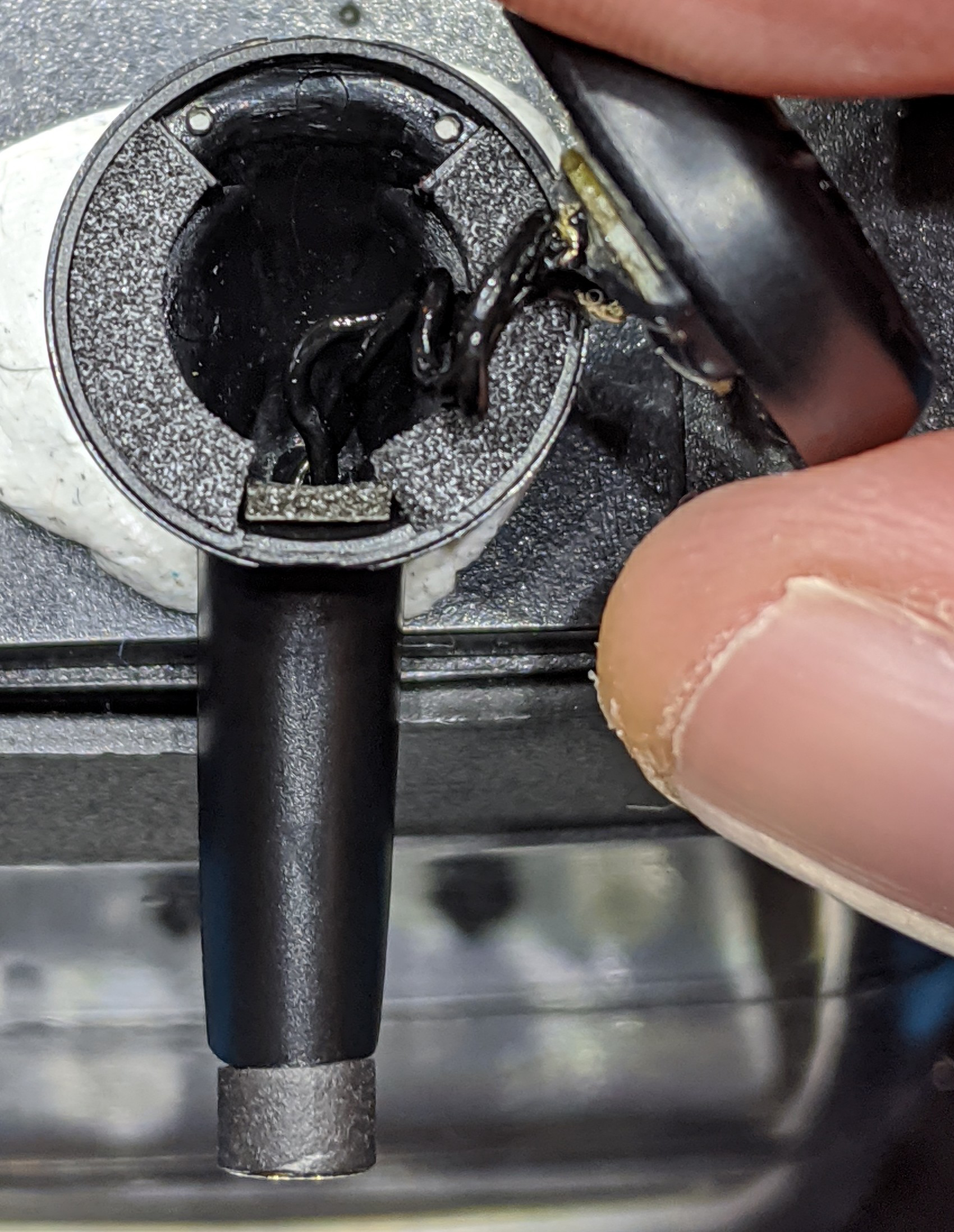

Thanks :) I modded the B40, tried out many different things with no noticeable improvement to be honest. I could recreate similar tuning to the original in many different ways, or alternatively make the sound worse :D The bass can be improved by damaging the mids, which is not my cup of tea so I stayed with minor adjustments compared to original. I drilled 3 holes in the end, tried different foam/tape combinations, closing fully or partially the top vent with blu tack etc. The only real advantage of the extra holes is that regular horseshoe tuning can be used instead of the less common rectangle type. Also it gives finer control over the sound but it won't really improve it. I only did one side so far, don't really have the motivation to do the same with the other half. Did not worth the effort so far. I would put the speakers in other type of shell but the diameter is larger than other usual 14.8mm. Maybe I'll try it in the z-sound shell and try the tape method.
