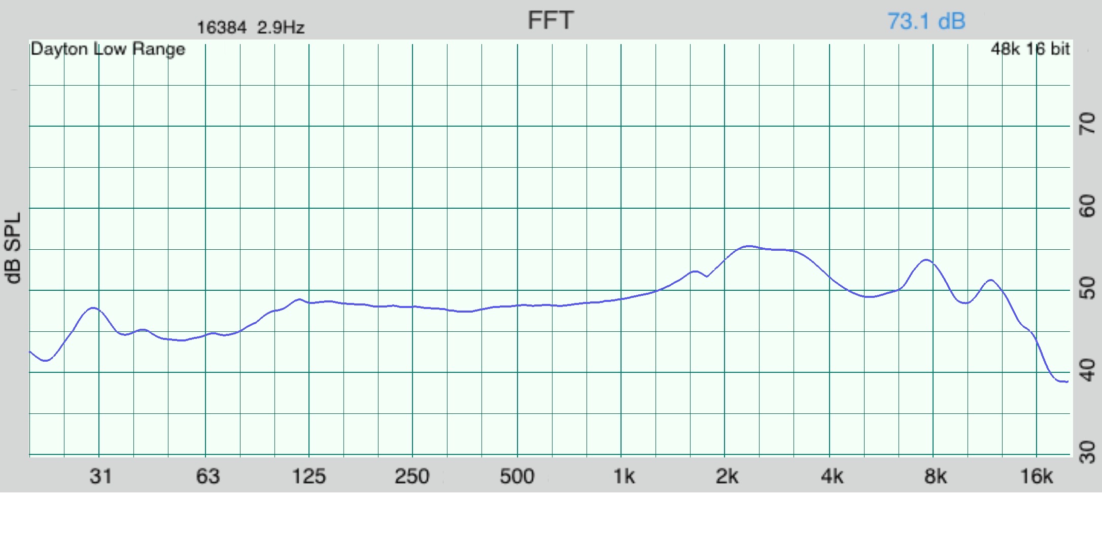

This is probably not an accurate frequency graph but you can see where is the peak for my 600ohn driver in a blue metal shell.
You can try to tune it by adding foam or wool pieces at the back, from the inside in front of a mesh.

Just did some measurements of these and wanted to share. I'll try and get my 600ohm measured as well as control set for reference.
These are two takes on measurements. The first is the common at eardrum measurement and second is more easily interpreted to standard raw graph measurements.
My measurements are not really accurate in lower registers but overall you can see bass, mids, and highs well. This shows a very neutral presentation. The 3khz area is not as elevated as something like an Etymotic. Which is what I was calling a mellow play back rather than warm. It's a slightly lower 6db elevation vs 10db elevation from 1khz to 3khz. Otherwise very much in the same ballpark.
