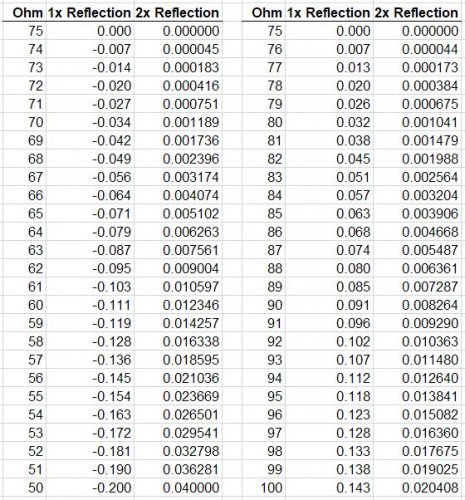

@ Jon L: stay cool !
I have (only) a 2qute, but if I compare pictures, it looks like that the same BNC connectors are used ... and if I check the board of my 2qute, very close to the BNC connector I can find a 85X resistor, which is a 75 Ohm resistor:
So, this seems to be fine, we have a "75 Ohm closing resistor". So the question is, how relevant is a (maybe) 50 Ohm connector with a 75 Ohm resistor ... I don't know. But I think the closing resistor is "much more relevant" than the connector. I made a tabular:
The tabular shows, how much reflections we have with a 75 Ohm cable on X Ohms end (DAC) !
E.g. we have a 1V signal running to a 70 Ohm end -> 0.034 x 1V = 34mV will be reflected and running back to the source (first = 1x reflection, minus means subtracted from 1V). In case of source has (also) a 70 Ohm end -> 0.001V = 1mV are running back to the DAC again (second = 2x reflection = 0.034 x 0.034).
So, in case of we use a 75 Ohm cable and the (maybe!!!) 50 Ohm connector with a 75 Ohm resistor creates maybe together a "70 Ohm end", we have the situation described in the example above. BTW, if source has a perfect 75 Ohm end, nothing is running back to the DAC, because second reflection will be 0.000 !
... and I still hope, the BNC connector itself has also 75 Ohm !
... and I'm usind BNC and I'm still relaxed, because BNC sounds great :)
Regards Tom
