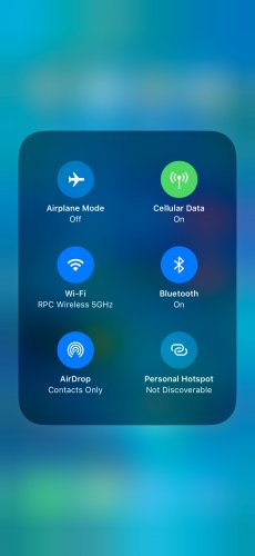

this is not my experience on iPhone X. i pull down Control Center, hold down the wireless connection square, then press "Personal Hotspot" once (bottom right corner in the picture below). and then i can close Control Center and it connects fine once discoverable.
