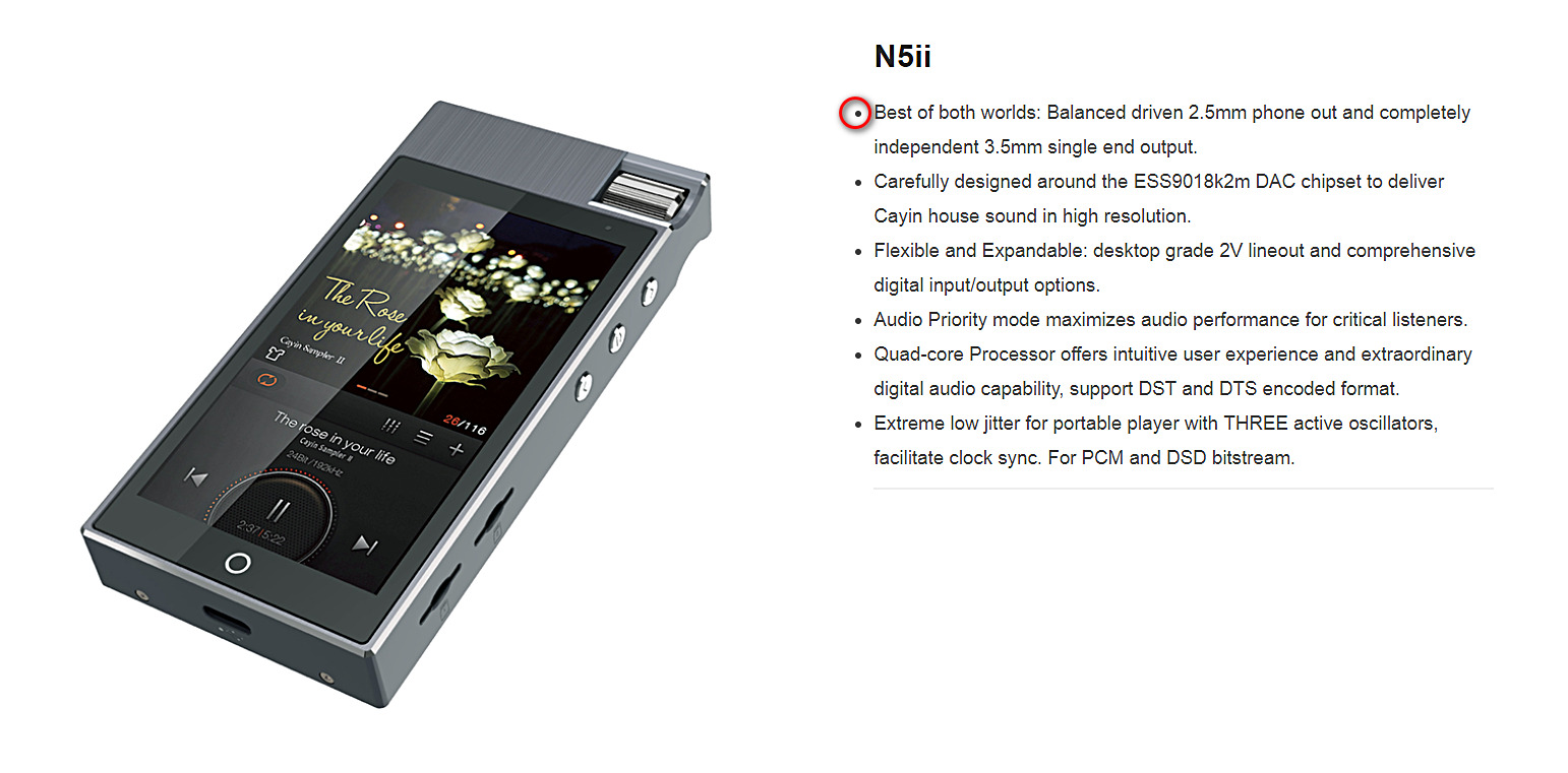

That's weird, man. Why use three 1622 chips when two would give you the same result?
Its all about optimization. If we were to use two OPA1622 only, the single end will use the L+ and R+ signal as the signle-end output, as a result, we have to use all the circuit design for balanced driven "as-is" for single-ended.
When we use three OPA1622 instead of three, we can design an independent circuit (including power supply, bias setting and grounding) to facilitate single ended headphone, and it definitely sound better then using part of balanced circuit as the base of single end. That's why we claim that N5ii offers best of both world in our web site, even the 3.5mm output is not compromised,

Fantastic! Thanks. Pinky supports that decision! :D
