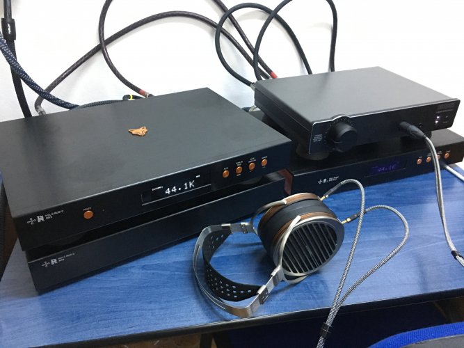

Hi to everyone!
I have a Holo May KTE for a month now and I will like to write my impressions since this DAC has been discussed here.
First of all I came from a Holo Spring 2 KTE DAC used in a headphone setup: MacBook-Audirvana-Ifi micro USB 3- DAC- Niimbus US4 - Susvara. I have this setup for more then 2 years now so I know it very well.
At first, when introducing the May in this setup it was a little odd. The sound was coming very wide on left and right but not in the center. After 300 h of burn in things are even now. From the beginning it appeared it has a more “hi fi” tuning, upper midrange and low treble seam more forward then the Spring. I tried different cables but the shouty midrange was still there. I used diferent sources, deactivated the PLL function but had the same results.
I thought that maybe my setup was not compatible with this DAC. Maybe it is to detail for my liking.
Don’t get me wrong, the May sounds great, very good separation of instruments, powerful bass, natural highs. And the best thing is the PLL system which is allowing any source to sound great (I have not seen any DAC until now that is so immune to poor digital source).
BUT the listening fatigue that this unit in this setup is given me was bothering.
So I end up getting a very good source (Mano streamer) and my old Holo Spring KTE (which I have sold to a friend) to make some critical comparisons. And here is what I found:
First using the PLL off on the May:
Holo Spring 2 KTE was surprisingly more clean sounding, more relaxed, effortless and pleasing to listen, from the same source. Holo May KTE was almost the same, just a little more dynamic and it had that fatiguing quality. Then I put some music that had quite passages and the truth started to come out. On songs like “Liberty” by Annette Askvik or “When the party is over” by Billie Eilist where there are some pauses in the music and then the sounds come almost like from nowhere, things that on Holo Spring 2 was an amazing experience and very well rendered, on Holo May KTE was a disappointment, the black background was never there, there was always a plankton noise from where the sound started.
Then I switched the PLL on and do the same comparison. This plankton noise was attenuated but not to the same level as the Holo Spring wick had 0 noise.
So, I think this is distortion of some kind. I tried different inputs and the results are the same. I hope that my Holo May KTE has some technical problems, and this is not a design problem. I already contacted the dealer to see what he can do.
It is unfortunately and a little outrageous that this thing is happening on a 5.600 euro DAC with KTE - presumably double quality check!
If you have other methods to test for distortion, please recommend me some.
I will report back with news!
