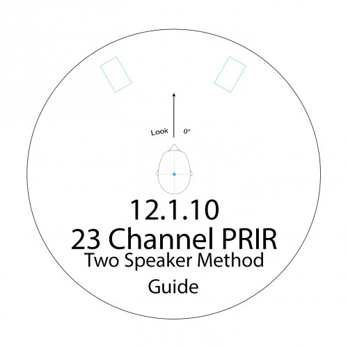

For the DIY kind of person... "How To Guides" will be soon available via the website as well.

Might be helpful to spend some time explaining what the difference is between these various multi channel PRIRs. For example, why would someone prefer a 23 channel Prir to one with 24 channels. Also perhaps a little discourse on how the size of the room affects the appropriate number of channels. Would be nice to come to a deeper understanding of this process.
I'll give it a whirl...
My explanations are based simply on the "ease / convenience" of "DIY" PRIR creation using the two speaker method.
In this example... The 23 channel (12.1.10) vs 24 channel (15.1.8) do have similar speakers used in their listening rooms... But precise care of speaker placement is necessary in the creation of 15.1.8 vs 12.1.10. This alone may be enough to choose one method over the other.
30° - Red
10° - Green
12.1.10: L, R, C, SW, Lw, Rw, Lss, Rss, Lb, Rb, Lrs1*, Rrs1*, Cr, Lfh, Rfh, Ltf, Rtf, Ltm, Rtm, Ltr, Rtr, Lrh, Rrh
15.1.8: L, R, C, SW, Lw, Rw, Lss, Rss, Lb, Rb, Lrs1, Rrs1, Lsc, Rsc, Ls1, Rs1, Lfh, Rfh, Ltf, Rtf, Ltr, Rtr, Lrh, Rrh
In the bed layer of the 23 channel (12.1.10) setup... All look angles are based on the Left (L) and Right (R) speakers being at 30° to the listener. Because of this 30° foundation... All other bed layer channels can be easily measured by simply turning to a set look angle based on the 30° of the Left (L) and Right (R) speakers... It gets a bit more complicated with the 24 channel (15.1.8) setup. This method can still be done with two speakers... But to get the appropriate look angles... the bed layer speakers must be physically moved to the corresponding look angles of 10° and 30°. In this comparison... The 23 channel (12.1.10) is less time consuming and requires less effort when compared to the 24 channel (15.1.8) setup.
As far as the sound of speaker placement is concerned... I personally find the two extra center channels of the 15.1.8 setup to be more appealing when it comes to dialogue. But the two extra top channels of the 12.1.10 setup do add a bit to the Atmos experience. Choosing between the two is difficult... But if "ease / convenience" are the main factor... the 23 channel (12.1.10) is hard to beat.
I can't really comment on this. But for me... The more speakers the better! 😀 In my PRIRs... I am trying to achieve the ideal (according to Dolby) speaker placement scenario. This is rarely possible (without, DSP, delay, etc) in an actual home theater environment... but can be achieved (virtually) using the two speaker measurement method.
* The current firmware requires a little trickery with the Lrs1 and Rrs1 channels of the 12.1.10 setup.
