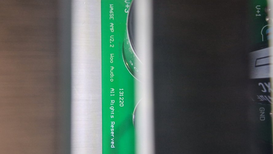

Actually, head-fi.org member Deyan is now building 6SN7 to 6DE7 adapters with a circuit that allows use of 6SN7 tubes with the WA6SE. I am currently using a pair of these excellent adapters on my WA6SE 1st Gen with Sylvania 6SN7 tubes made in 1952 and a Western Electric 422A rectifier.
Member 2359glenn used to make this type of adapter. When I asked him to build some for me, Glenn said he no longer made them and referred me to member Deyan in Europe who built the adapters for me. I had them in my hands in Virginia two weeks after I ordered them. I could not be happier with the adapters.
Member 2359glenn used to make this type of adapter. When I asked him to build some for me, Glenn said he no longer made them and referred me to member Deyan in Europe who built the adapters for me. I had them in my hands in Virginia two weeks after I ordered them. I could not be happier with the adapters. deyan Woo adapter.jpg
could you tell me where i get 6sn7 adepter for se 1gen ?do you know the link?thanks.
