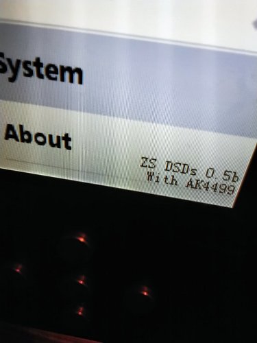

My Zi DSDs D4497 have schizophrenia. Today was 3rd time he thinks is 4499. Turbo mode apires in menu and stop give me sound when music was played. Need to remove TF card and push reset button.
Can't recover to Dual4497 still 4499 in system info.
