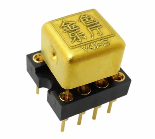

Did anybody test this...?
i had asked some time ago for similar chinese opamps (in opamp thread)
https://www.head-fi.org/threads/the-opamp-thread.432749/page-377#post-13610281
and got these replies;
My guess is they are fakes. HDAM is an acronym for - hyper dynamic amplifier module - a term used by Marantz to describe their pre opamp circuits. SS3601/2 is a Sparkos designation for their opamps. And the PHILPS at the bottom does not inspire any more confidence. Most likely rebranded 49720/49710HA if you are lucky. Maybe something crappier. If they were legit and good there would be more info out there.
The AMP9920AT is very funny stuff, it's a cheapo SOIC8 chip(5532 IIRC) fitted in a T099 case at premium price, you can find pics of it being cracked open on google.
It's your lucky day, PM search finally works again so here goes: https://www.jdbbs.com/thread-5699748-1-1.html
I hate fakes, but in some convoluted way, I enjoy seeing this type of fakery. So much effort to try and get you to plunk down $45 only to be completely pissed off (if indeed it sucks). Complete ballsy griftering brings some facet of entertainment for me...unless I was the one who bought one! Hahah
