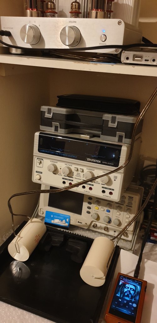

I'm almost done with my upgrade, I'm really new to tube circuit design, so I have a question whats the reason for that 100uf Cap to Ground? 20210919_165202~2.jpg
This is how my upgrade looks so far, I had issues with ground loop/hum for that 100uf cap but after soldering to its original ground the hum is gone.
It looks like you answered your own question! :)
The cap here helps filter out noise, usually high frequency, but it looks like in this design it also helps with mains hum.
