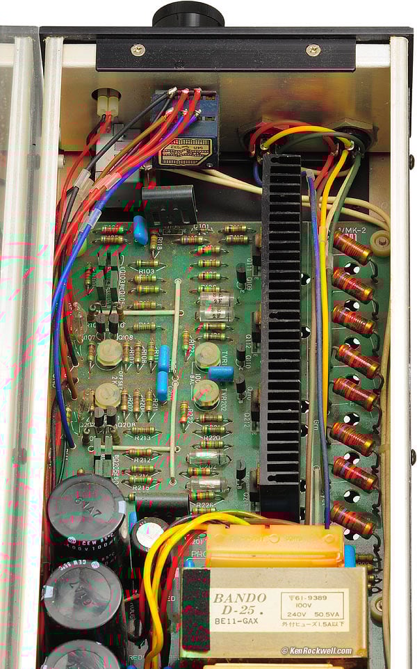

I've got an SRM-1/MK2 I want to pre-emptively recap.
I found https://www.head-fi.org/threads/stax-srm-1-mk2-re-cap.648596/, but have a few questions I was hoping people could answer!
1: I think I found the Panasonic FM EEU-FM1V471, I'm fairly certain amazon has them here. Digikey/Mouser both have a long lead time.
2: I can't find the Panasonic EET-ED2G221CA, any ideas for a replacement? What am I looking for in a replacement? I know I need to have a snap on capacitor, at least the voltage and capacitance rating, and something that fits in the original footprint. Is it just ESR I need to look for? Is lower better flat out better here, or do I want to aim for a match with the original?
3: Spritzer says that "Remember the labels for the pots are swapped on the PCB so offset is balance etc.". That just means when I'm doing the balacing/offset as described here that for Part A I actually adjust the pot labelled offset, and for Part B I adjust the pot labelled balance. Do all SRM-1/MK2s have this swapped, or do I need to check this?
4: Should I re-apply some kind of tape to keep the pots from changing after adjustment, like they come stock?
5: I have a 100 V model with the selector switch area covered by a plate. Is there a guide for converting that to 120V? It's as simple as reconnecting a cable to the correct spot, right?
I plan on taking it apart tonight and getting some detailed photos, but looking through the grates it appears identical to this.
Thanks for any help!
I do have experience soldering, so once I figure out the capacitors to get, I don't think I will have much trouble replacing them!
Here's some quick pictures of the amp internals. Looks identical to the one in the thread I linked here. I'm a bit confused as to how to wire it up for 120V, although it appears to support that configuration!
Any help would be much appreciated, thanks!
