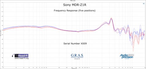

We did share some information about what we measured with. I did comment on the differences we found while doing our measurements. Our results are not consistent with Tyll's, and that was also said. Nothing I've said discredits Tyll.
well "inconsistent" is a very polite way to indicate that something is/was wrong, yes you mentioned directly that it could be the Headphone he got, but the issue is that your measurement is the inconsistent one. An the reality is what Tyll and others have measured shows a pattern, so either Sony sent out 6 defective headphones and yours is the correct one or your measurement is in reality inconsistent. Let's assume that the one you gusy have is "defective" or the outlier... that would be TOTALLY OK!!! In fact it's GREAT that you've measured something different, different angels and experiences build the community as whole but to refer to his measurement which is really a strong representation of an average as inconsistent really discredits every one else.
Hiya Jude,
Here's my response: https://www.innerfidelity.com/content/head-fi-contradicts-innerfidelity-sony-mdr-z1r-measurements
I'd really like to see the compensation curve you're using and the raw measurements. Do you move the headphone and average to do some spatial filtering?
I'd love to get you the headphones I measured and would love to measure a pair of yours so we can do a little more correlation.
I think your measurement rig is SWEET!
I'll shoot you an email.
YAY, this is what I've been excited for. I hope that moving forward from here, we can get some clarity onto why the HF measurement was/is so different from all the rest.

Thanks for the link--I just read it. If the headphone's not an outlier, then I do think you're right about #1 (quoted below) being the likely reason.
1. The geometry of his head may be different than mine and may not measure the 10kHz area the same as mine. It's clear from Audeze's comments about measurements on various systems that this might be the case.
...I'd really like to see the compensation curve you're using and the raw measurements. Do you move the headphone and average to do some spatial filtering?...

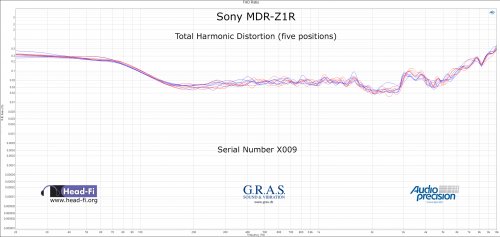

Yes, we always test in multiple positions. For the DF-compensated plots, we're using KEMAR DF (I'll send you the values). Here are five positions, no DF compensation applied, frequency response and total harmonic distortion (click for larger size):
FR - Sony MDR-Z1R - Serial X009 - RAWx5.jpg THD - Sony MDR-Z1R - Serial X009 - RAWx5.jpg
...I'd love to get you the headphones I measured and would love to measure a pair of yours so we can do a little more correlation...
That would be groovy. Email response forthcoming.
...I think your measurement rig is SWEET!
Thank you, Tyll. The big website switch delayed our projects related to such, but we're getting there.
