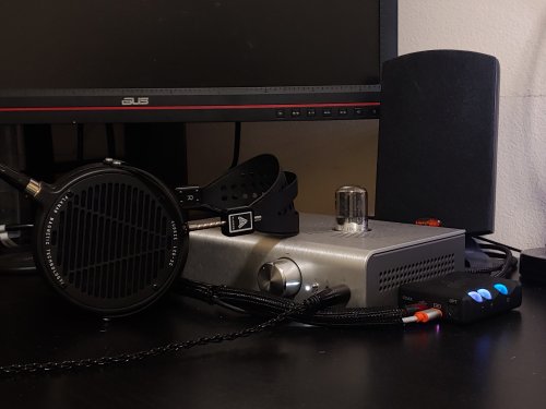

Ooh, there really is something nice about these Sylvania Bad Boys. I may even like them more than the Kenrad Black Glass since the mid-treble is a bit more opened up, and I can still get the same bass impact and soundstage as the Kenrad.
I do notice clearer resolution and less veiling in the Bad Boys, which helps since I've EQ'd up the bass for the Audeze and that still hits hard, but I don't lose as much in the mids/trebles as I did with the Kenrad.
This may be the better pairing for the already somewhat darker Audeze, too.
