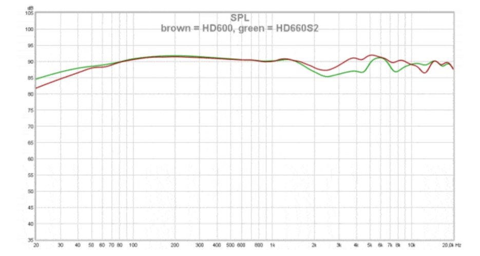

Nope. Talking about impedance, not frequency response. Here's what I was talking about:
While people usually talk about these headphones as "300 Ohm" headphones, it might be more useful to talk about them as 300-600 Ohm headphones when matching them to an amp. I presume that this is also the reason that a high output impedance amp (like a Bottlehead Crack) brings bass to these headphones. Low output impedance amps with moderate power output probably just roll off the bass region entirely and might even struggle with the upper treble.
Could explain why these headphones sound pretty "flat" to me, even if their midrange still sounds fantastic. On a typical solid state amp with very low output impedance, the HD 600 might actually be something like an upside-down v-shaped tuning (is "^-shaped tuning" a thing?).
While people usually talk about these headphones as "300 Ohm" headphones, it might be more useful to talk about them as 300-600 Ohm headphones when matching them to an amp. I presume that this is also the reason that a high output impedance amp (like a Bottlehead Crack) brings bass to these headphones. Low output impedance amps probably just roll off the bass region entirely and might even struggle with the upper treble.
Could explain why these headphones sound pretty "flat" to me, even if their midrange still sounds fantastic. On a typical solid state amp with very low output impedance, the HD 600 might actually be something like an upside-down v-shaped tuning.
Oh ok, I didn't catch impedance.
