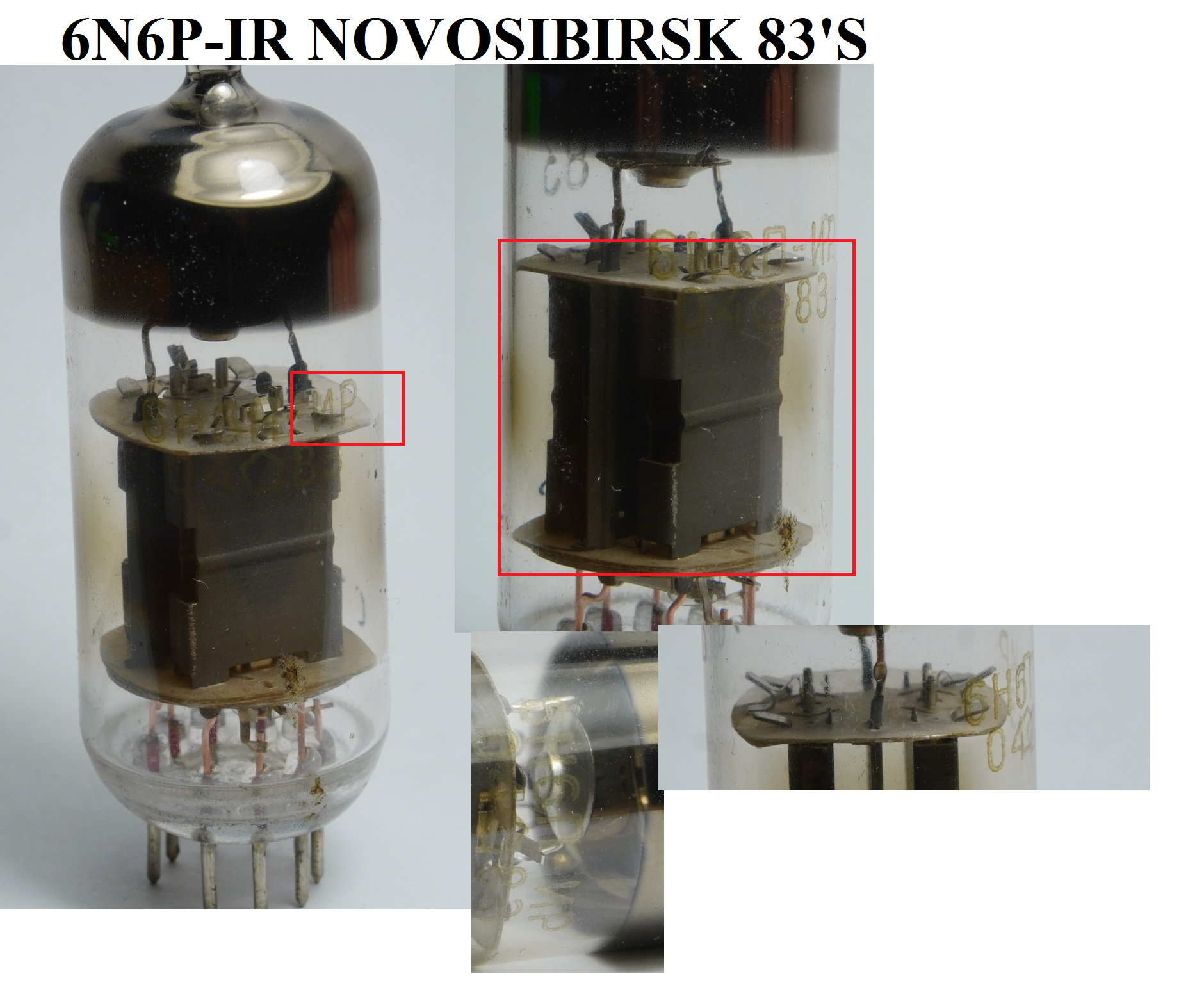

And at the end, a very rare version 6N6P-Ir (NEVZ) with a box-shaped anode! Some rate it higher than 6N30P-Dr (but also the filament current is 0.9A)
