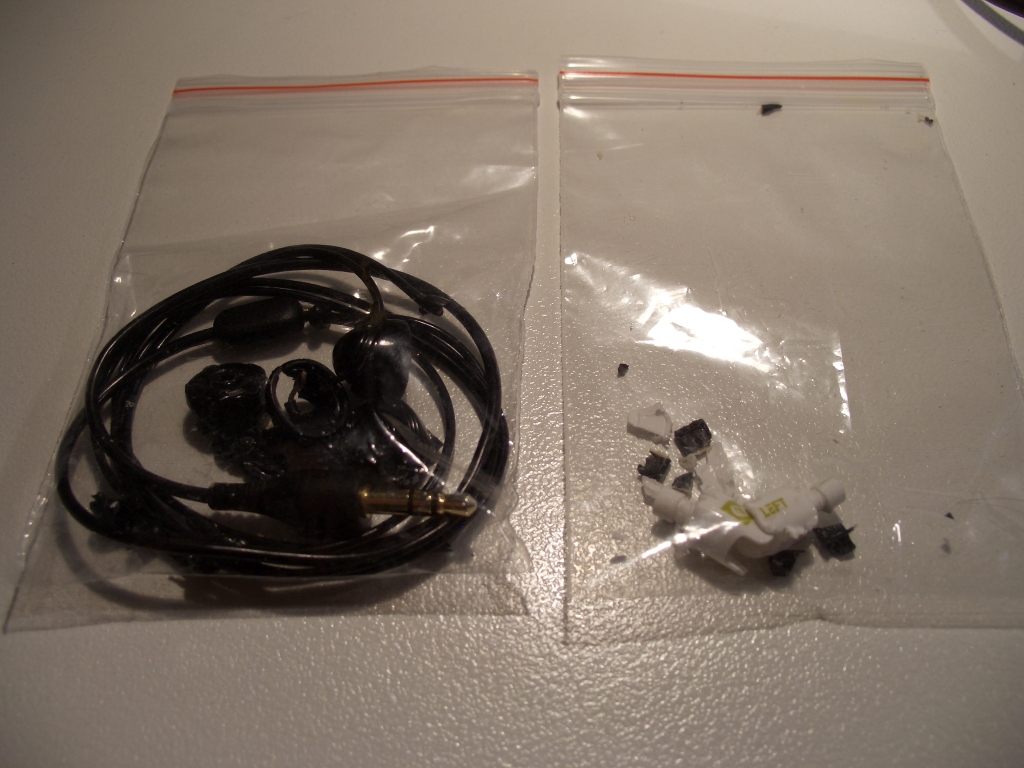

What's left of the existing earphones:
What's in the [bag] now:
