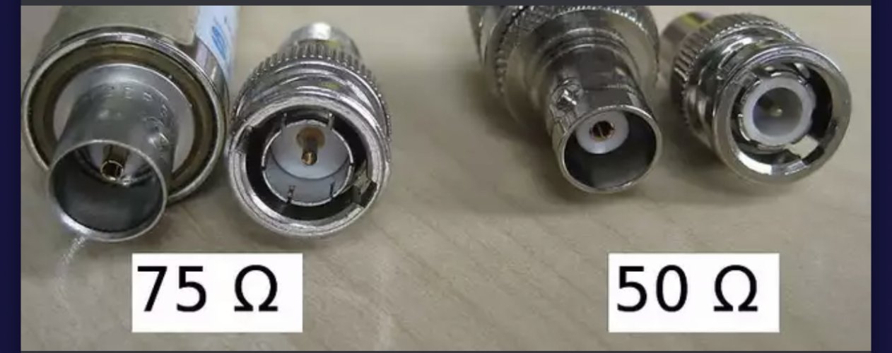

But the connector is 50Ohm. So I need to buy 75cable with 50ohm connectors?because they are not the same.
This is far out of my mental reach. Im gonna wait with patience till Kingwa get focused on one …pure native 75ohm. My patience went up a lot.
No, even though it's not optimal, 50 ohm plugs work with 75 ohm jacks, and 75 ohm plugs work with 50 ohm jacks.
And both @DACLadder and I have done listening tests with mismatched setups and not found them to be detrimental over short distance, as @DACLadder said.
Don’t worry about 75/50 Ohm connectors… What matters is the impendence of a wire used … Some manufacturers (Gustard) been using 75 Ohm BNCs on their 50 Ohm "clocked" gears for a while now … Again, really good 50 Ohm clock cables are expensive and hard to find …
