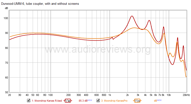

I was going to say I definitely noticed a difference the filters had. See my measurements on a set I thought was ruined before the replacement filters became available. A lot of the screens do impact sound, so when people remove the mesh screens and claim a "veil" has been lifted is normally because now the fitlered peaks are present. The Kanas Pro filter seems to be centered at around ~2.4Khz, which also affects the 2nd harmonic at the ~4.8khz mark.

Thanks a lot for the information and graphs! Now to figure out which screens to buy. I wonder if the different screens are “tuned” differently, or are just of different diameters.I was going to say I definitely noticed a difference the filters had. See my measurements on a set I thought was ruined before the replacement filters became available. A lot of the screens do impact sound, so when people remove the mesh screens and claim a "veil" has been lifted is normally because now the fitlered peaks are present. The Kanas Pro filter seems to be centered at around ~2.4Khz, which also affects the 2nd harmonic at the ~4.8khz mark.

I guess that's why people have been saying the Starfield feels "bland". The dampening effect these filters has is tremendous comparing to something like... well, the Shouer SingerWow, that’s a strong peak smoothing effect the filter has.
https://banbeu.com/graph/iem/shuoer-singer/
