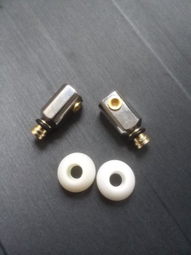

Got myself a new solder iron and finally finished modding my ATRs. I also decided to install mmcx connectors in my ED9s. It was kinda fun to breath some new life into a couple of old favorites.

BadReligionPunk
Any guide for the ed9 mmcx mod? I mean I would be quite content with ed9 at work all day if I could pimp a different cable or even possibly a BT cable.

Sorry I don't have a guide for the mod and I didn't think to take any pictures of the process. If you have experience soldering other iems or small electronics it shouldn't be too difficult. The two most challenging parts of the mod are widening the hole that the connector is going into and the lack of space inside the ed9s. To widen the hole, I used a dremel with a cylinder shaped diamond burr bit and just went slow checking the fit frequently. A pair of needle nose tweezers is pretty much a must when soldering the wires to the drivers and if you have a pair with a curved tip that's even better. I used the type B connectors in this link.Any guide for the ed9 mmcx mod? I mean I would be quite content with ed9 at work all day if I could pimp a different cable or even possibly a BT cable.
https://m.aliexpress.com/item/33035633031.html
