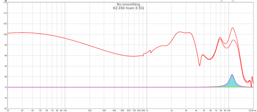

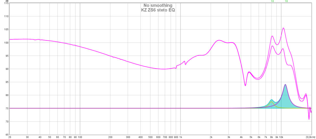

measured again zs6 with different tips, trying to match same distance between BAs and mic (~2.55cm). used 192kHz 24 bits this time.
noticed differences between a narrow foamie and a bigger one; the narrow cuts off less 11kHz peak than the wider.
following @xrk971 hypothesis ("An 11kHz peak would imply something at 1.55cm deep - which may be the hard leading edge of the silicone earplug tip. So changing to foam tips may remove the 11kHz peak") which seems to explain the foamies effect, maybe more surface or more compacted foam in the wider ones help.
anyway, based on last measurements i got, have tried some simple EQ settings for silicone, small and big foamies. and i'm enjoying the zs6 very very much.
silicone
-2.5 dB 8000Hz q=6.0
-9.0 dB 11000Hz q=4.0
foam S
-6.0dB 11000Hz q=4.0
foam M/L
-4.0dB 11000Hz q=4.0
if you don't have a parametric equalizer, you'll get similar eq by using a band equalizer, if you can access to 11kHz band (and to 8kHz for silicones).
you can play with your desired gain (the above gains provide a bit more treble than zs5, but that's my preference), and with the frequency offset.
EDIT: due to different insertion and singular characteristic of each ear, the peaks can be located at different frequencies. in order to extend the tolerances, it's better to use lower Q than 4.0; this way you'll catch the peaks better wherever they are.
This is the last eq i've tried with foam tips (L size), which includes lows taming (bass bump is huge for my taste), and forwarded mids:
low shelf filter: 400Hz, Q:0.2, -8.0dB (bass taming)
peak filter 4: 800Hz, Q:0.4, +1.5dB (mids forwarding)
peak filter 6: 8200Hz, Q:4.0, -2.0dB (highs taming)
peak filter 7: 11300Hz, Q:2.0, -4.0dB (highs taming)
(click to enlarge)
EQ filters action:
Silicone:
foam S:
foam M/L:
