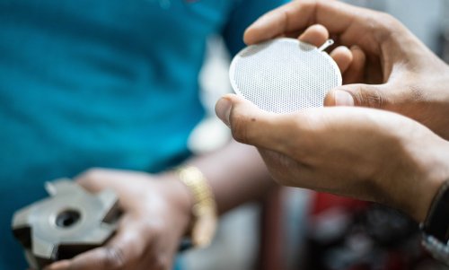

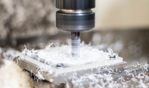

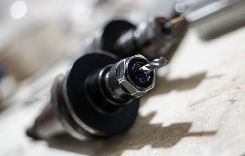

Today is another Story post.
This time, it's about @Kaldas Research's machinist, Mr. Sachin.
Many believed that the CNC revolution would end the Legend of the Master Craftsman. A mere program would end the precision of human skill. Well, we disagree.
Mr Sachin is a fascinating man. With an Aerospace past, he was solely responsible for machining Jet Engine parts from scratch. Mr Sachin indirectly served for the Indian Air-Force for over four years. Mr Sachin then moved onto working on 5-Axis Machines in the U.A.E. for his extraordinary skill in machining Titanium. He joined Kaldas Research in 2016.
If one needs to witness Man and Machine harmony, Mr. Sachin with his CNC's is a sight to behold.
His expertise has enabled Kaldas Research to develop and manufacture every single part of the RR 1 Conquest, from the chassis components to the Transducer elements completely in-house.
We also salute Mr. Sachin for his service and contributions to the IAF.
A true Master Craftsman.

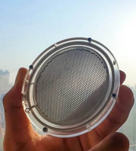

We spent over a year perfecting tolerance matching for our Stators and Spacers. Our spacers have an average accuracy of 0.005mm across 200-250 points. Which is as good or even better than a very experienced and highly respected Electrostatic manufacturer.
During the development of the RR 1, we made at least 4 different variants for the Transmission assembly. Two of which we think are completely novel and patentable. The RR 1 doesn't employ either of those due to the significantly higher Manufacturing cost. We will introduce those Transmission systems for future products.
In our CNC fleet we have one 3-Axis HAAS Automation VMC and another 3-Axis Kitamura. Also a 3-Axis Inventables Carvey that I keep at my office for quick prototyping. We also have access to 5-Axis systems although we don't own any 5-Axis, yet...
We still think the RR 1's driver is a peach to look at. Maybe Science can be Art?

Very nice looking stator. What material do you use for making it?
You commenting here is a great honor for me, Sir. Your contributions to the community are a treasure.
The Stator is Aluminium, around 0.8mm which goes through multiple flattening operations to make sure it's faced to the correct dimension, something not required on FR4.
