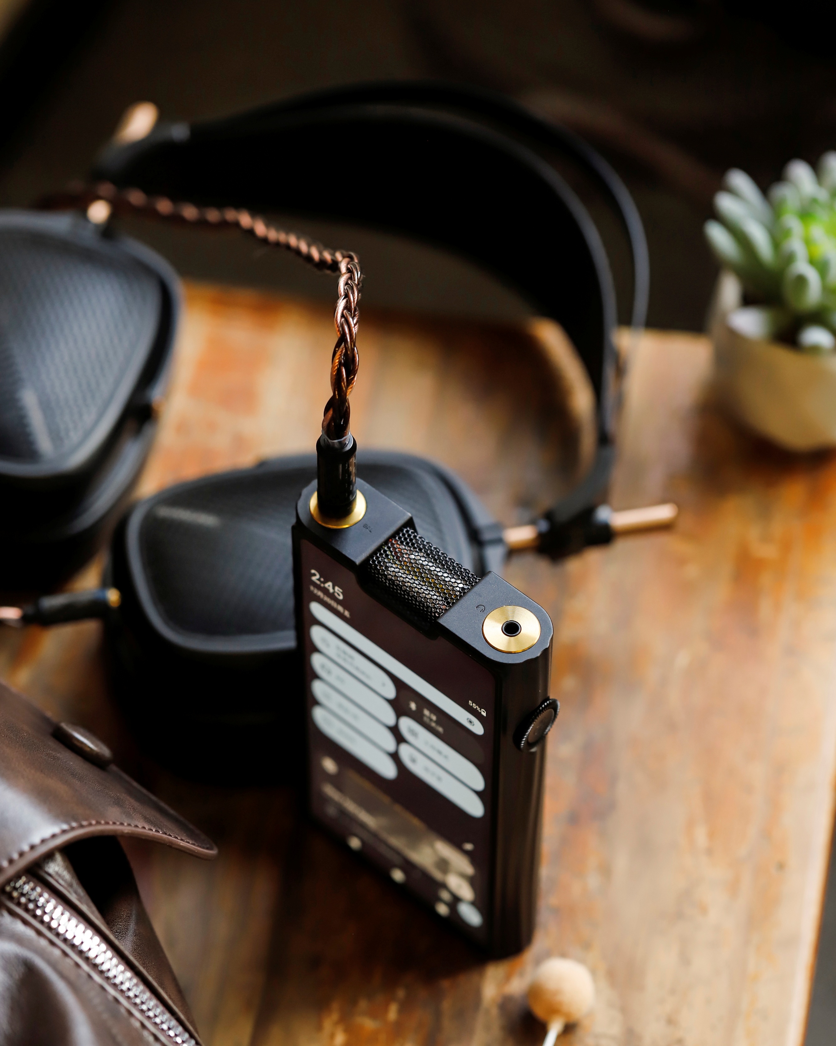

Shanling M8T represents one of our most impactful releases in recent memory, as it brings alongside many aspects of the Shanling’s heritage, while taking a significant step towards the future of our Android Portable Players.
Starting with the most obvious, M8T is our first portable player with built-in Tube output. Shanling’s history is closely connected to Hi-Fi tubes, as they were prominently featured on some of our most acclaimed CD players and Amplifiers over many years. So it was about time to bring them to our lineup of Portable players, with a pair of JAN6418 tubes implemented into the top of the M8T.

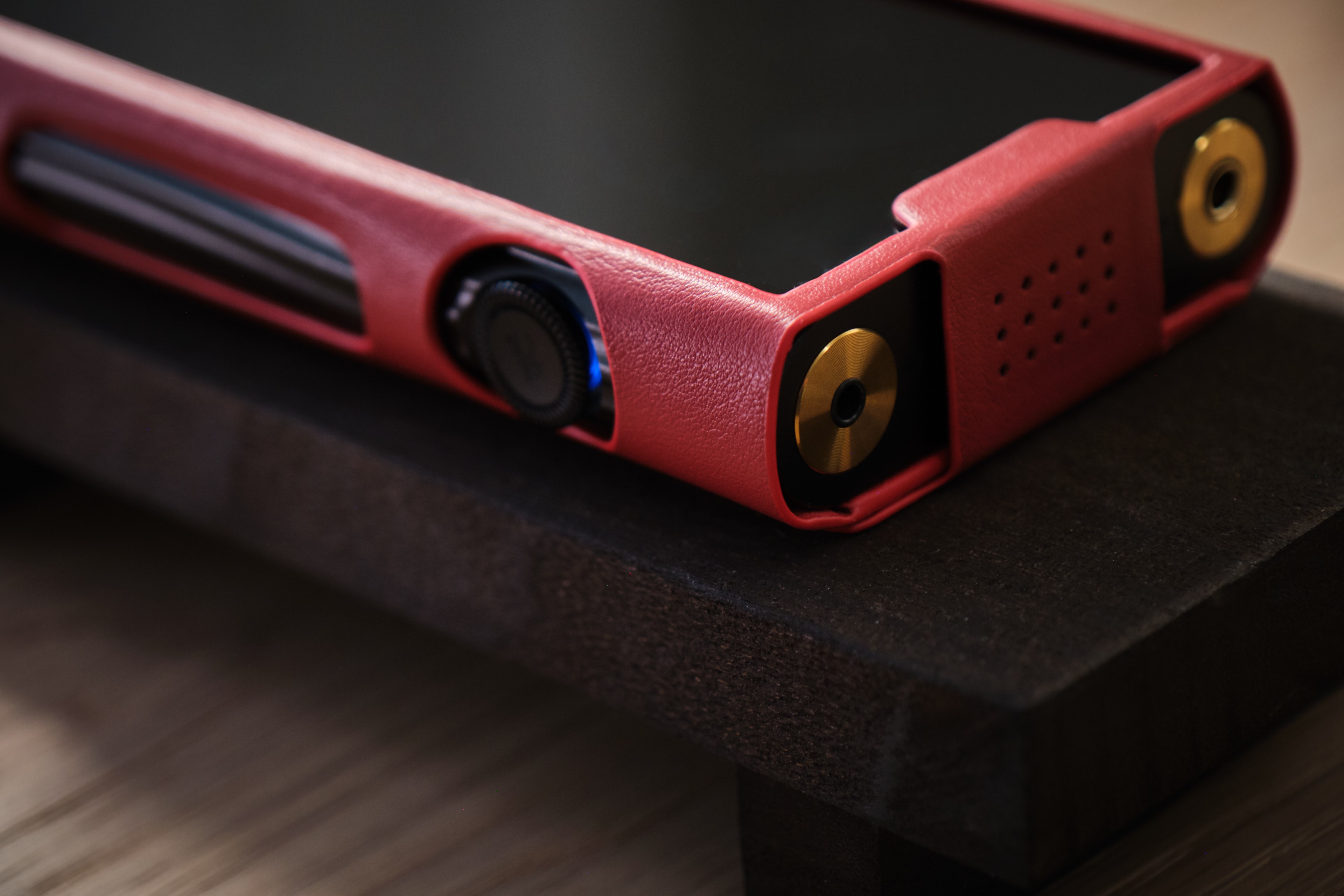

Leather case providing additional protection for the tubes.
Case available in red or black versions.

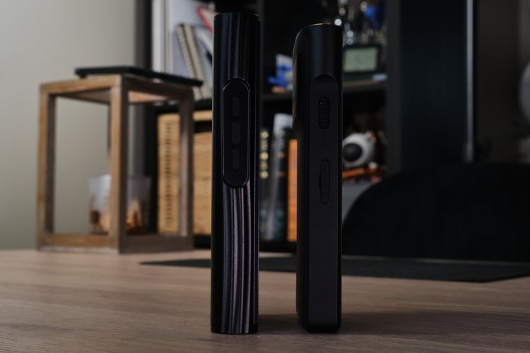

If M9 and M9+ had notch, then M8T has anti-notch :)
What are the physical dimensions/weight?
Dimensions
M8T: 147 x 82 x 22mm
M9+: 147 x 82 x 22mm
M9: 152 x 82 x 22mm
Weight
M8T: 383g
M9+: 379g
M9: 409g
