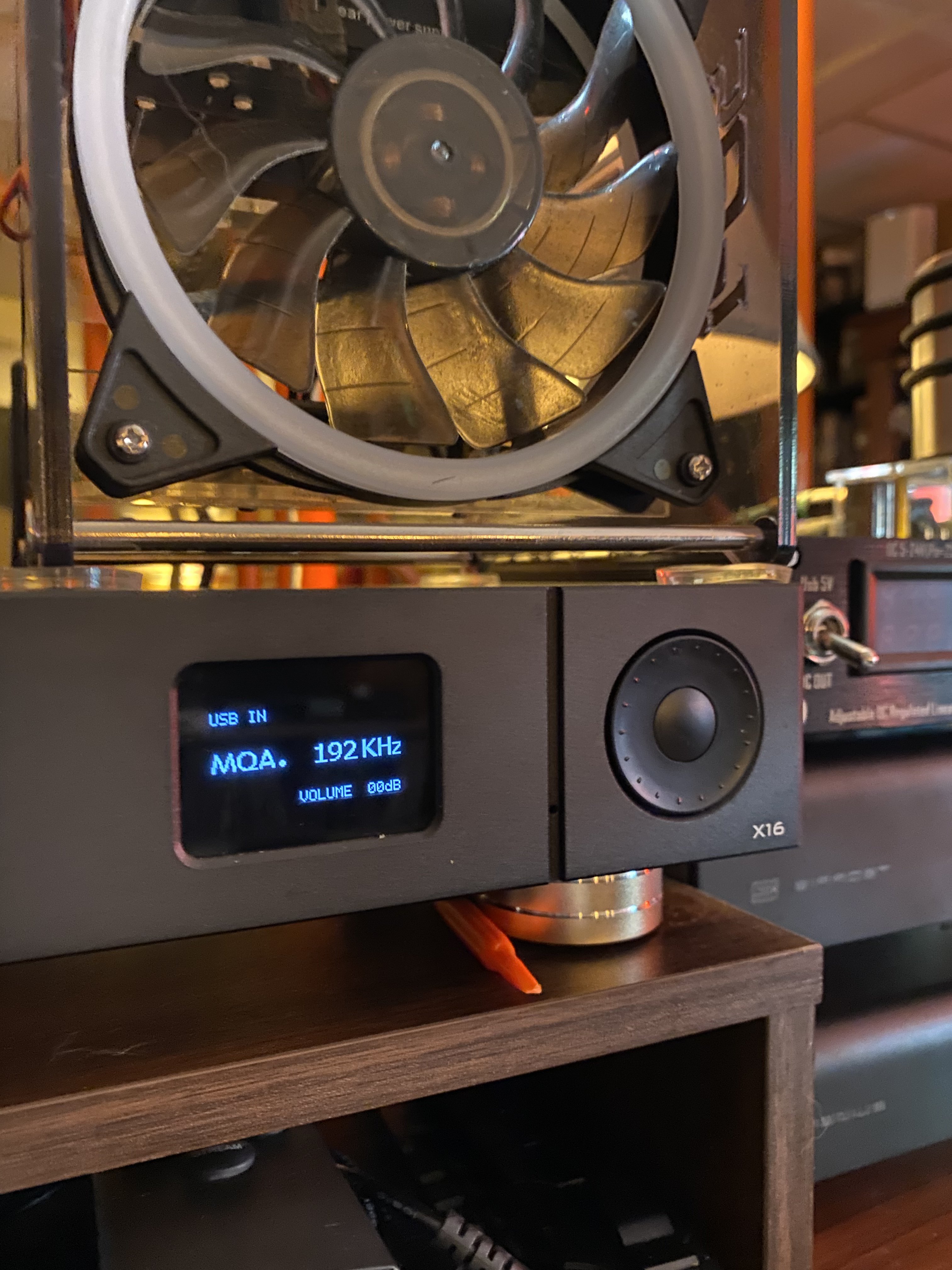

Looks to me your setup is actually proving my point, you DAC should be reading MQA Studio then the correct unfold.
Instead it reads OFS 192KHz.
Try the free version of the mConnect App with Tidal and then take a look at what you DAC says.
"OFS 192 kHz" is fine. He's still getting the full "MQA Experience."
In this case, the TIDAL app is performing the first unfold (MQA Core Decoding) and the DAC is acting as an MQA Renderer, completing subsequent unfolds, DAC-specific rendering, etc. End to end, the MQA stream is still 100% decoded. Even with a DAC that supports full MQA Decoding, this division of labor between media player software and firmware in the DAC can be advantageous. There can absolutely be sonic advantages to seeing "OFS" or "MQB" on a DAC instead of "MQA."
Hey @dsnyder look I can make my Gustard do tricks!! 🤣🤣🤣
I mean, sure.
Any DAC capable of full MQA decoding can do that. Just depends on settings and behavior upstream in the media player.
One strange thing I found with a direct USB connection between the NEO iDSD and my MacBook Pro is that I could not get TIDAL to do the first unfold. Regardless of the "Passthrough MQA" setting in the TIDAL app, I was getting "MQA." on the display. That's broken…or at least not what I would expect. There should be a way to get TIDAL to complete the first unfold if I want…
Unrelated, but when streaming via TIDAL Connect, I was never able to get the DAC to show "OFS". It was not detecting an MQA stream at all, so showing "PCM 96 kHz" instead of "OFS" or "MQA." Thinking back, this may have been over S/PDIF instead of USB, but the NEO iDSD supports MQA decoding and rendering via both inputs, so that should not have mattered. Gustard only does MQA Decoding over USB, but it will do Rendering over the other inputs.
