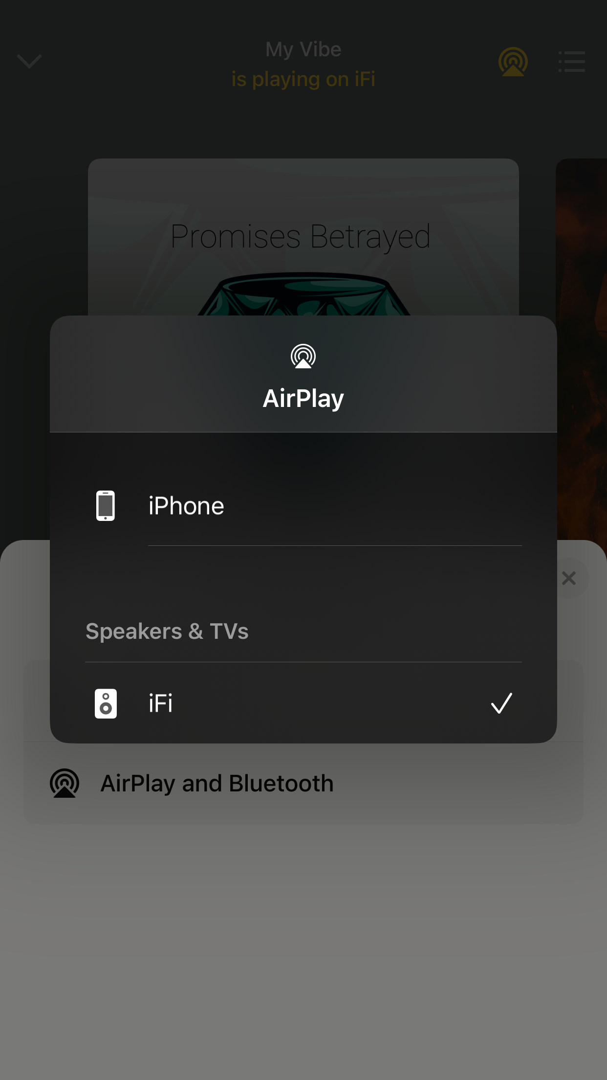

Current Firmware...
2.32.9 (Airplay 2 Added functionality)
Current "Beta" Firmware
Please refer to this post directly from @iFi audio regarding "Beta" versions
https://www.head-fi.org/threads/ifi-zen-stream-setup-tips-tricks.961425/post-17345803
