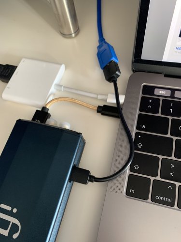

And again ... it just happened while I am writing this text ... I was listing to my music and the Signature turned off (battery is empty) because it used the internal battery only all the time even if it is pluged in via USB to my MacBook (connected via USB-C). But I do not have a separate charger here and therefore I can not continue hearing my music. Sorry, but this is just *****.
Currently I am thinking about to return it. This is frustrating me a lot. Faulty construction in my opinion.
Edit:
And I can not even charge it via my USB C port of my MacBook (check attachment)

This exactly is what concerns me and I mentioned before. Ifi conviniently skipped to make any remark on that. Why would a 500mA USB (the is the minimum that a USB port on a laptop or computer would put put) not be enough to run and change the device. Or in this case to just run it (without charging). Why would it shut off? How can it be using so much more than power? That is just bad design. You shouldn't need to haul around a seperate charger for this. The whole point of USB is so that it can be charged from PC/Laptop.
As I said I am personally happy with the seperate charging port. But no one should tell me it is a good implementation if a laptop cannot keep it running on a "dedicated" USD. As you can see on that picture.
I would really like some clearity on this. If the previous version could run with computer USB power, then why can this one not? (yes, with seperate USB connected to the charging port). How did BL version and the rest manage this before?
The +100mW is definitely not the reason. Or rather shouldn't be, unless someone messed up.
Something is not right or that unit is broken.
IFI give us some no BS insight please.

As far as I know, the Thunderbolt-3/USB-C port of my MacBook can output 2,1A which should be more then enough because it is more than 50% of the charger I carry at home. Do I really have to take a charger with me all the time? @iFi audio
Nov 4, 2020 at 2:46 AM Post #306 of 2,391
As far as I know, the Thunderbolt-3 port of my MacBook can output 2,1A which should be more then enough because it is more than 50% of the charger I carry at home. Do I really have to take a charger with me all the time? @iFi audio
Something is not right. 2.1A x 5v = 10.5Watts. There is no way that is not enough to charge this thing. That is enough to charge anything.
Maybe your unit is faulty? Can you confirm you could charge it from other source? I mean how were you able to run it till now? Or are you saying that it can charge. only not at the same time as it is running?

Ok, I finally found a charger.
But I need 3 cables + external charger to use this device. Sorry, but really ...? With the BL I just needed 1 OTG cable and I was done.
@qsk78 you still think that this is an improvement compared to the BL? 🤔

The white box is an adapter to connect external display. You can ignore it. But you would still need 3 cables + external charger.
But you could buy a larger USB-C to USB-A cable as connection to the charger. Than you would have „just“ 2 cables and one charger compared to one single cable for the BL

I use this USB-C to USB-A cable to connect the Signature with the external charger. Because it is not possible to charge it with a Mac/PC/whatever via USB. You need an external charger. I do not know why. If I could charge it via USB-C to USB-C (cable between Signature and MacBook), it would be ok. Still one cable more and one feature less compared to the BL, but I could live with it
