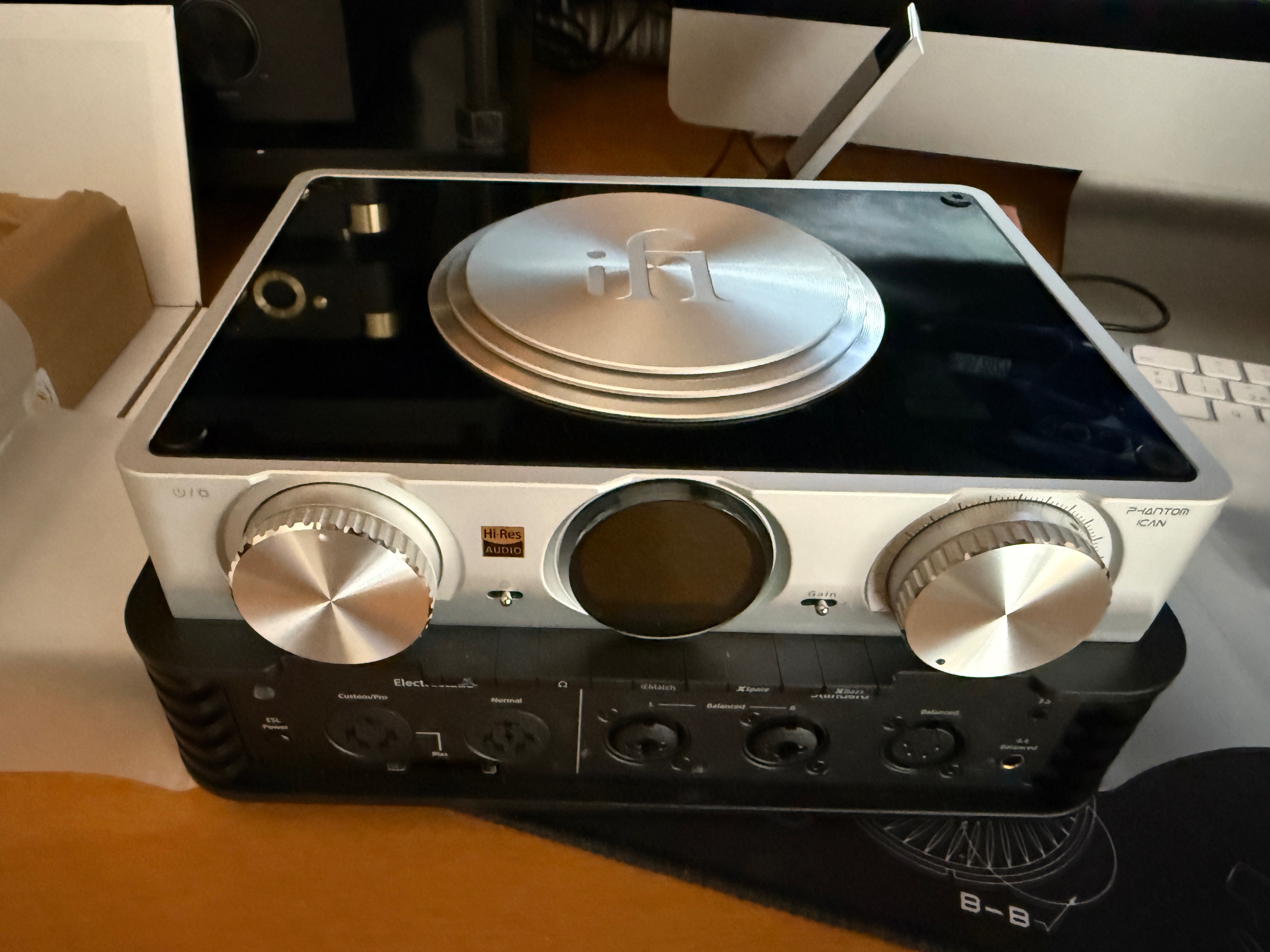

Great info, will do all you recommend later today. Why not use the iDSD plugged into the iCAN on Pro Fixed and only on Hifi Fixed, will the higher voltage damage it or is it a fidelity thing?
Also, do you know why my iDSD has this static shadow of an image behind the numbers of letters. It is hard to see but you can see it, look at the 4, you can see circles and swoops in it (Kinda looks like the the number 6) along with them in the PCM?
Looks like "burn in", something OLED displays are infamous for.
The original Pro Prototypes actually used static On/Off LED's behind what you might call "translucent aluminum", like so:
Unfortunately these do not look good on Photos (or Video) unless you get exposure "just so" which doesn't happen in darkened rooms at hifi shows, though it looked spectacular in reality.
So a late redesign to OLED was ordered after the product was already in essence production ready and caused both production delay on an already delayed product, but it also left the usual small OLED Display problems (noise, difficult to read display at distance, burn in).
The OLED display is quite noisy and some of this bleeds into the audio (arguably at < -130dB). Still, I fond the iDSD Pro sounds best with the display completely off. Running the display at high brightness will cause burn in - I think what you see are the big numbers from the most common sample rate displayed.
Thor
